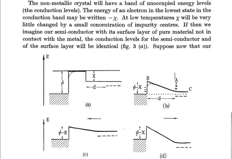

I mean the X in the attached picture. This is from Mott's paper of the metal-semiconductor rectifying theory. He just said it varies a little and even did not mention what was its name.

I think what he tries to explain is that the work function is not identical to the electron affinity.
Note that the electron affinity is defined as the difference between the zero level of energy and the lowest state in the conduction band far inside the semiconductor. That means it is a bulk property and by definition does not depend on the band structure near the surface.
