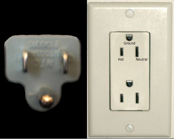

rollingstein Jan29-13 05:02 AM
Re: conflict in AC electricity
Quote:
Quote by berkeman (Post 4247158)
By code (at least in the US), the Neutral wire is Earth grounded at the breaker panel. So there is very little voltage developed between the Neutral wires and grounded metal surfaces.
If Neutral gets tied to Earth what's the purpose of the third grounding pin / wire that's sometimes found?
http://upload.wikimedia.org/wikipedi...Type_B_USA.jpg
Studiot Jan29-13 05:39 AM
Hello mickybob, Berkeman is quite correct, the building neutral is earthed by code in the US.
This is not the case in Europe, where it is illegal to earth the neutral.
This is because the two distributions system work entirely differently.
Hello rollingstein.
The neutral in both systems carries the return current.
The aditional earth in both systems should carry zero current in normal operation. It's sole purpose is for safety protection, in which case it carries a fault current, sufficient to blow the fuse or breaker. It also serves to prevent hazardous potentials developing on exposed metalwork.
