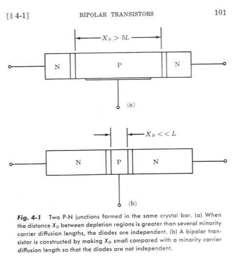

Bill, you ask "What's a good way to explain the inner workings of the BJT to children?"
My answer is, of course, the 2 diode back to back model. After diodes are explained to children, then the 2 diodes can be explained. A thick base region behaves like 2 back to back diodes & nothing more. As the base region is made thinner, transistor action is then observed.
The CC model, namely Ic = alpha*Ie, works very well. For 2 back to back diodes, the Ic value should only be a small value, that associated w/ the c-b jcn reverse leakage current. Namely Ic = -Ics*exp((Vbc/Vt) - 1). After all, the c-b jcn is reverse biased, so little current can flow.
The emitter current Ie is given by Ie = Ies*exp((Vbe/Vt) - 1), of course. So we have
Ie = Ies*exp((Vbe/Vt) - 1).
For 2 diodes, that is the truth, whole truth, & nothing but the truth.
But when the base is so thin that the 2 junctions are in extreme proximity, another term is added to the eqns.
Ic = alpha*Ies*exp((Vbe/Vt) - 1) - Ics*exp((Vbc/Vt) - 1).
The added term is in bold font. Personally, this explains bjt action w/o quantum mechanics. The "alpha term" accounts for the emitted carriers from the emitter, transporting right through the base before most can recombine, then continue onward into the collector. The better the transfer, the closer alpha is to unity.
Honestly Bill, if the target is children, & QM is off limits, is there a better explanation than the 2 back-back diodes w/ ultra-thin base width? If there is, please enlighten us. BR.

So, how can we explain BJTs to children? To design an explanation, first describe the basic BJT operation verbally:
  1. Base current controls the BE junction voltage
  2. BE junction voltage determines height of BE potential-barrier
  3. That potential-barrier sets the rate of charges crossing the BE junction
  4. Most carriers from the emitter make it all the way to the collector
  5. Ic approximately equals Ie
No heresies so far? :)

I believe the problem lies in #3. How does the potential barrier "set the rate of charges crossing the b-e junction"? I'm afraid that we are right back at the endless chicken-egg riddle. Does voltage "set the current" or does "current set the voltage"? Until we grapple with that vexing riddle, we will argue ad infinitum, which I am not going to do with anybody.
The power/signal source driving the amp stage is what sets the current. Then when carriers cross the junction recombination takes place for a small minority of carriers. Ionization occurs, & the local E field increases slightly due to the slightly increased charge distribution at the barrier zone. Vbe increases slightly.
This results in a slightly greater Vbe drop at the increased current level. The important point is that the rate of charges crossing the junction is determined by the power incident on the signal source driving the whole network. Using my singing Susan example w/ a microphone works well. Sue imparts acoustic energy to the mic diaphragm. Mechanical/acoustic power is converted to electrical power. The voltage drops due to cable resistance, the rbb' base region resistance in the bjt, the Vbe drop, & re, all subtract from the mic generated voltage.
The Vbe drop does not solely determine Ie. Rather, Ie is the net voltage after drops, divided by the total loop impedance. Vbe does not control Ic, but they are intrinsically & indirectly related. Here's how the events take place.
1) Sue sings into the mic.
2) Current & voltage are generated at the mic diaphragm. The ratio of V to I is the mic cable characteristic impedance, Zo.
3) The I & V move along the cable & encounter the bjt amp stage. Along the way cable resistance results in collisions & a charge distribution forming a potential barrier. Signal gets attenuated.
4) At the amp stage input carriers incur base side collisions due to rbb', & emitter side collisions due to re. Attenuation occurs.
5) Then the carriers cross the b-e junction. Most nake it to the collector but a few recombine in the base & ionize local atoms.
6) This changes ther barrier charge density & potential. The current is again attenuated.
7) If Sue cranks up her volume, the additional charges outputted by the mic add to the b-e barrier increasing Vbe.
Bottom line, Sue is the prime mover, she makes everything happen. Her volume determines all currents & voltages. She can sing loud, soft, or in between. Nothing happens until Sue makes it happen.
Rbb', re, cable R, cable C, b-e diffusion capacitance, b-c Miller cap, & barrier potential play a role. But none of them exclusively determine the current crossing the junction. Sue determines that current mostly, but there are drops due to rbb, re, & Vbe that diminish Sue's output. If Sue's mic outputs Vmic, each quantity cable R, rbb, re, & Vbe drop a portion of Vmic, leaving maybe 0.78*Vmic, or 0.63*Vmic, whatever.
If all drops were zero. Sue dictates the current. But nonideal parameters mentioned above rob a portion of Sue's signal. Thus, Vbe, rbb, re, & others do indeed play a partial role in "setting the current", but all are minor roles.
Sue is tha main entity that "sets" & determines the current crossing the junction. Is my explanation clear. BR.
