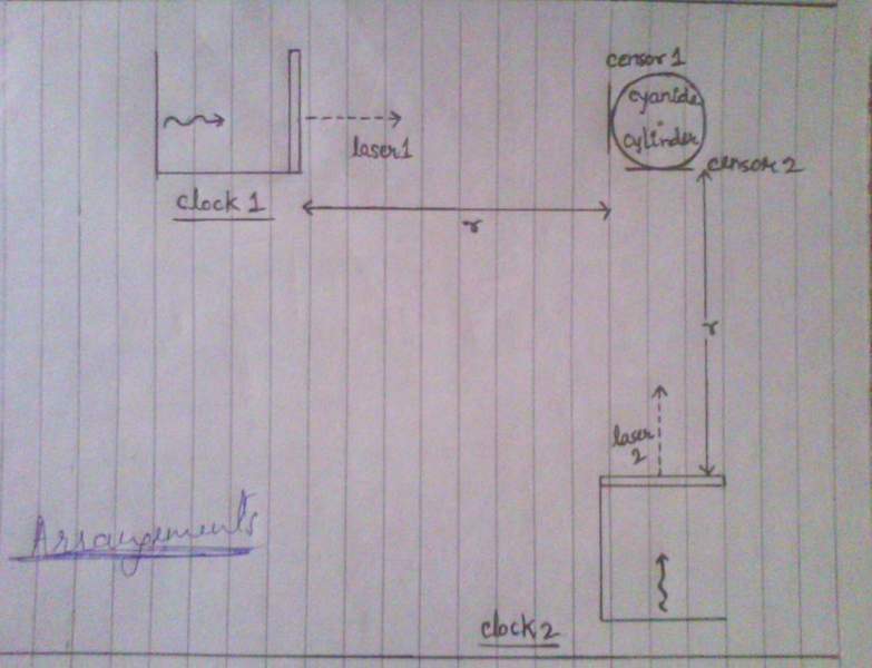

here is the arrangement...

Quote by Nakshatra View Post
Since the two sensors are, for all practical purposes, at the same location, if the lasers strike the sensors at the same time in one frame they will be seen as striking the sensors at the same time in all frames. However, since the lasers of the two clocks are spatially separated, frames will disagree as to whether the laser pulses were fired at the same time or not.

Dec31-11, 02:21 PM   #24
Mentor
Blog Entries: 1
it is actually not an answer to my question..
*cylinder will remain close only if the two lasers (or say a photon)reach those censors at same time.
*the clocks will be synchronised for the ground observerB if they are synchronised for the oberverA (as both will be dilated by same amt.)
Here the question is not only about the starting time of the two lasers,most important is that whether the two lasers(or a photon) reach their respective censors together or not.
~the two lasers will start at same time for observer A(in the cab)
~the two lasers will start at same time even for observer B (ground)as they will dilate by same amount.
~the two clocks are synch. in frame of observer A,
and they will remain synch. for observer B;as they will dilate by same amount.
Any kind of disturbance in their time will open the cylinder.
main motive of my paradox is to investigate the dependency of death and life on frames.
Just because the light clocks both dilate by the same amount (for a round trip of the laser pulse) does not mean that they are synchronized in all frames. If the lasers start at the same time according to cab observers, they will not start at the same time according to ground observers. However, the one way travel time for the laser pulses (from starting point to the sensor) is not the same for both clocks according to the ground observer.
If the lasers start at the same time according to the cab frame, the pulses will reach the sensors simultaneously. The ground frame observers will agree that the pulses reached the sensors at the same time: According to the ground frame, laser 1 fired first, but the pulse from laser 1 took longer to reach the sensor, so both pulses reached their targets at the same time. No paradox.
No they will not. There is more than time dilation at play here. There is the Relativity of Simultaneity. The clocks if synchronized for A, will not be synchronized for B. The clocks will tick at the same rate, but will be offset from each other.
Both observers agree that the photons arrive together, they disagree as to whrther or not the lasers fired simultaneously or not.
No, see above
No, see above
(*Don't get me wrong i am not arrogant;i am just trying to ruled out every possibility which is making me feel that i am right...searching for an answer which can fully satisfy me
go through the problem from starting again... if necessary.)
It seems that you have never grasped what the Simultaneity of Relativity means. It means that events that are simultaneous to A are not so for B in a very real sense if they are separated from each other in the direction of the Relative motion between A and B.
