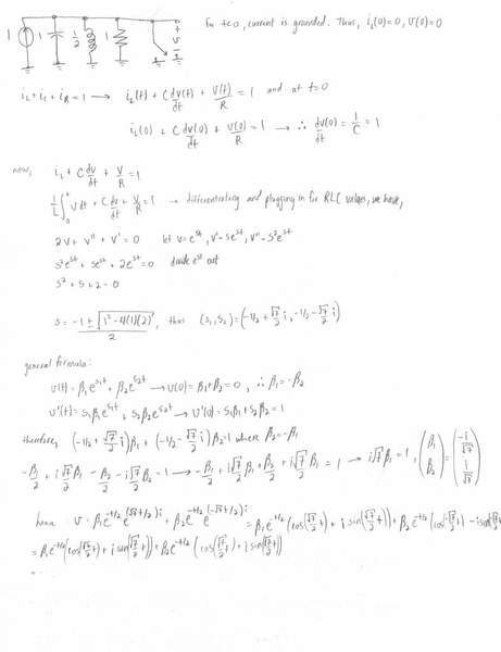

Here is my physical work. at t<0 the switch is closed. It opens at t>0. The final steps end up canceling out, and i cannot figure out where I went wrong.

rude man
#6
Jan18-12, 09:14 PM
HW Helper
Thanks
PF Gold
rude man's Avatar
P: 4,856
What did the instructor say about I? Is it zero for t < 0 and = I for t > 0? Is I constant for t > 0?
I will assume I(0-)= 0, I(0+) = I constant
It often helps to invoke one of the basic circuit theorems, in this case Thevenin. So redraw with a voltage source V = IR in series with R, then C and L dropping from the r/h/s of R to ground.
Now you can perhaps see what the initial conditions are:
1: vC(0+) = 0 (initial charge on C = 0 so vC can't change instantaneously)
2: L looks like an infinite impedance initially, so all current goes into C, which is I/R. But i = Cdv/dt so dv/dt(0+) = I/C.
Now your equation is the one you came up with, almost:
Cv'' + v'/R + v/L = 0.
Note the rhs is 0, not I. That's because when you differentiated your original equation you didn't differentiate both sides.
The rest is routine sol'n of a 2nd order diff eq. with constant coefficients and given initial conditions.
NOTE: A 2nd order diff eq has to have 2 initial conditions (not more, not less), a 3rd three, etc.

P: 4,856
Quote Quote by sandy.bridge View Post
It's hard to read, but my biggest problem is you substituted actual values for L, R and C. This should never be done until the end. Why? Because doing otherwise deprives you of the ability to track dimensions in each term of an equation. I find lots of math mistakes that way.
rude man
