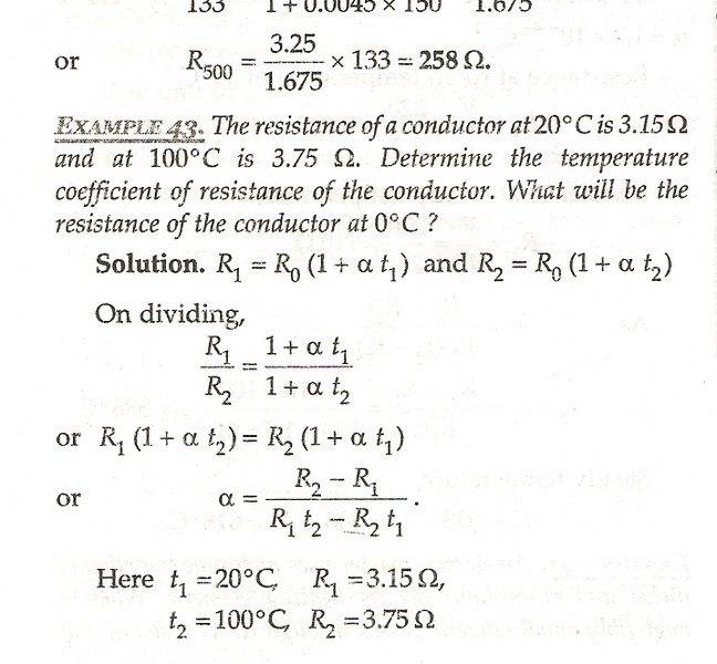

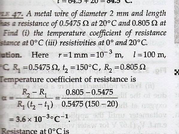

When we are supposed to calculate the value of "temperature coefficient of resistance " i.e. α , how are we supposed to choose between the following two formulae :
α = (R2 - R1) / (R1*T2 - R2* T1 )
or
α = (R2 - R1)/ [ R1 *( T2-T1) ]
I have attached scanned pictures of two similar questions . I can't understand as to why diff. formulae are being used in both of them

My second formula is the same as yours.
The first one can be derived as
R1 = R0(1 + aT1) ...(i)
R2 = Ro (1 +aT2)... (ii)
Divide (i) by (ii)
And you'll get the 1st formula.
Both formulae are correct.
The difference in their usage is that When T1 is 0deg. The 1st formula changes to the second one. But when I came across this particular question where T1 =20 deg (the one I've posted before) and still they are using the second formula, i got thoroughly confused. So, if you have any idea, please help.

Use the one that is correct. The second formula agrees with the link I posted, so use that. The first formula can be arranged to R=Ro(1+αT)/(1+α*To). Does that make sense compared to the first formula, which is R=Ro(1+α(T-To))?
Yes, that is the correct one.
Divide (i) by (ii)
Your derivation is wrong. R1 = Ro(1+α(T1-To))
They both can't be correct.
In order for the formula to be correct, it must be correct across the whole temp range, not just one temperature. Use the one proven to be correct.
