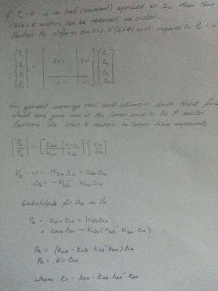

How can I turn a 5x5 matrix into a 4x4? I really cannot remember and I need to do it in a coursework I am doing :/ I have a handout on how to do 4x4 into 3x3 but the handout is very confusing.

I was given a method of how to turn a 4x4 into a 3x3 so it is easy to solve which involves moving stuff about and multiplying things. I'll go take a picture of the notes in a minute. We have all to turn a 5x5 into an equivalent 4x4 but I don't totally understand how to.

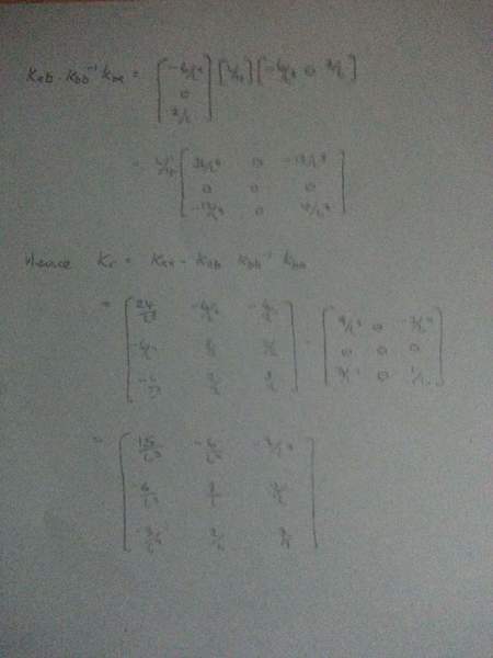

Here is the method I was given of turning 4x4 to 3x3

Well sam, I see you are talking about partitioning the stiffness matrix when you have a matrix equation relating the vector of forces (loads) to the vector of deflections.
You can do this because you are introducing a compatibility relationship.
Partitioning is not the same as reducing the matrix.
Why did you not post this as an engineering question where it might have been more quickly recognised?
What is the actual problem you are trying to solve? - please name your symbols.
Does this help?

You are able to reduce the size of the matrix because the values of some deflections are known, eg usually zero at supports.
Thus a set of 5 equations can be reduced to four if one deflection is zero.
This is what was meant by insert the zero in your notes.
I cannot say more without more detail.
