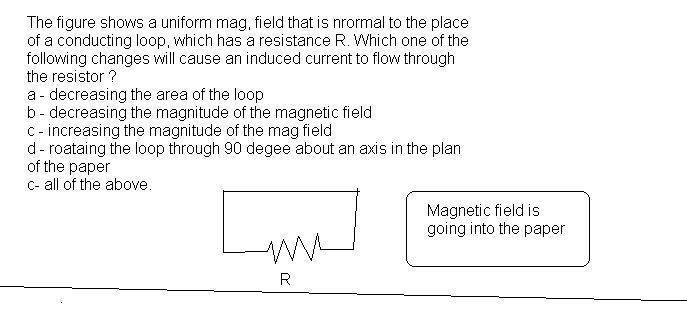

For pic/question 1 - Will the answer be
d - roatating the loop 90 degree ?
Would it make sense that since the magnetic field is going into the paper i would want the resistor (R) to be perpendicular to the Mag field ?

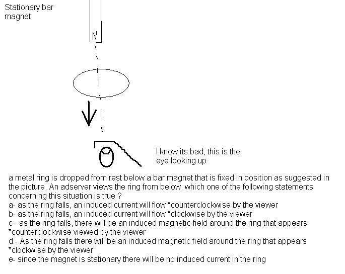

question 2
My answer would be
d- induced magnetic field clockwise.
Reasoning- using the right hand rule with the thumb (V) pointing down, my fingers would rotate around clockwise. :confused:

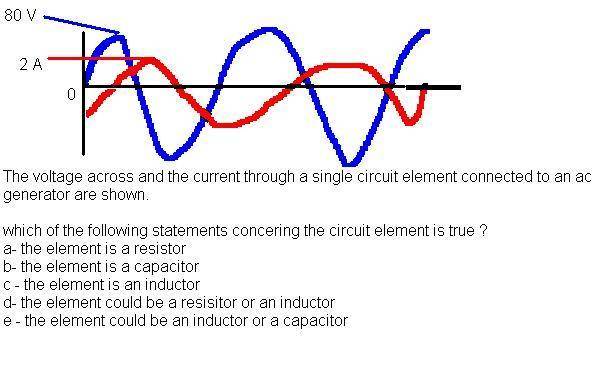

Questions 3 (last one for tonight - tried)
I would say that the answer is
C- the element is an inductor
Since the voltage leads and the current lags behind makes me choice this one.

Q1. Current will be induced in the loop if the magnetic flux through the loop is changed. Flux incorporates both the strength of the magnetic field and the area that the field goes through.
a) will cause a decrease in the amount of flux through the loop, since the area of the loop is reduced the amount of flux going through the loop changes - which will induce an current through the loop (any change in flux will induce a current, no matter if it decreases or increases)
b) will decrease the flux through the loop since the magnetic field is decreased - again a change in flux
c) will cause an increase in flux through the loop
d) will present less area to the magnetic field to go through as it is rotated, so a flux decrease will result, which will induce a current through it
So all of the changes will induce a current in the loop.
PhillyGixxer said:
question 2
My answer would be
The answer is A. Use the right hand rule, with the magnetic field going perpendicular to the wire, out from the magnet (out from the centre of the circle), and you use the force opposing motion. When you do this, you will get the induced current going counter clockwise around the ring from the viewer's perspective.
Q2 This is an application of Lenz's law. The flux through the ring decreases as it falls downwards. The induced current should therefore be such that the magnetic field that it generates will cause the flux through the ring to increase.
