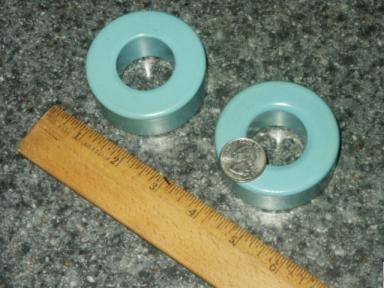

Hey Everyone,
I recently got a hold of a coupe of toroidal cores that I want to wind some wire on (see pic). They are roughly 2.5" OD, 1" ID, 1" thk. I plan to wind two coils of 20 gauge magnet wire onto them but I was wondering if anyone here knows how the factory-made ones are wound? Do they have some kind of special jig to do it or are these things still hand-wound? If there is a winding jig, how does it work, I am thinking about trying to make one but I'm not sure how I would do it.
Thanks,
Jason O

The winding machine we use (Jovil Universal) first puts the wire onto a circular shuttle ring, and then that is spun around the toroid to wind the core. The wire is kind of spiralled inside of the shuttle (which is a hollow ring about 3cm in overall diameter and about 2mm in inner diameter size), and the shuttle ring has a split so that it can be put over the toroid after the wire has been spiralled into it. Here's their website, but they don't seem to show any closeups of the winding head and shuttle:
http://www.jovil.com/
For your hand wiring, you need to put the length of wire onto some sort of spool that is small enough to fit through the center of the toroid. That way you can keep passing the bulk of the wire through the center of the toroid as you wind it.

I'll try in words first. Imagine a bigger version of the shuttle ring, say you took a drinking straw and could bend it into a circle with a small gap left. You take the magnet wire, and form it into a tight spiral the same size as the inside diameter of the straw, and push the spiral of wire into the straw from one end. You end up with a long spiral of wire through the length of the straw, with the final end of the wire sticking out of one end. You are limited in how much wire you can pre-stage in the shuttle ring by the thickness of the wire and the size of the shuttle. This determines the max number of windings you can get on the toroid.
Once the shuttle ring is filled with the spiral of wire, you open the split in the shuttle ring slightly so that you can put the shuttle ring over the toroid, with the split positioned in the center opening of the toroid. You then attach the spinning rubber wheel things to the shuttle ring, hold on to the exposed end of the wire, and start the machine. The rubber wheels spin the shuttle ring, while the toroid is slowly rotated by another set of wheels to evenly distribute the windings.
So the whole trick to this particular toroid winding machine is how they spiral the wire into the inside of the shuttle ring prior to doing the winding step. As I said, winding any toroid involves putting the wire on something that you can then pass through the middle of the toroid multiple times. In your case, that would probably just be a small spool.

Hmmm... a bit hard to describe since I haven't actually done any sketches for it except on paper.
Basically, it's sort of like the spool that fishing line comes on, except inside-out (ie: a 'conveyor belt' made of channel material with the open side in, configured similar to the 'hoop' in the video). It opens like a bracelet to insert the toroid, then is closed.
A 'slider' is then threaded onto the free end of the wire from the original spool and snapped into a track in the channel to maintain tension and prevent tangles. That's the part that's giving me fits right now. I haven't been able to find anything lying around that meets the requirements. Right now, all that I can come up with is to use a mandrel-bent tube and grind the inside part off to create the channel.
The end of the wire is then taped to the inside of the channel, and the channel spun up to load it with as much as it will hold.
Anyhow, once it's ready, you do a couple of winds by hand to start it off, then run the motor in reverse to unwind the wire onto the toroid.
A slow gear train, ratchet, or stepper motor increments the orientation of the toroid each time a turn is completed. I haven't spent any thought on that yet, since it's the easiest part.

Okay, I'm going to do something ass-backwards here to save time. I'm at work with no access to my drawing programme, so I'm going to go ahead and post the assembly instructions that go with it before the drawing itself. Of course, it won't make much sense until you can see what I'm referring to. It'll be up tonight if nothing goes wrong.
To start with, the hoop is composed of 4 x 1/64" aluminum rings, two of which (the 'inner' rings) are 12" outside diameter. That is also the size of the 2 'spacer' rings, which can be composed of plastic or whatever and are 1/32" thick. The 'outer' rings are 12 1/4". All have an inner hole of 11 9/16" diameter. The perimeter of the hoop is composed of 3/8" wide steel banding material such as is used to package lumber. You can get scraps from any lumber yard or hardware store, but will have to remove the rustproofing coat (easy). Just make sure that there are no kinks or creases in it. It needs to be 37 1/2" long. You also need 4 'studs', which are 3/32" bolts about 1/4" long with the heads ground down to 1/32" thickness, with 3 matching spring washers and nuts. The hinge plates and latch can be any fairly strong, thin material such as 1/32" aluminum.
PROCEDURE
1) Tape the band end-to-end in a 12" outside diameter circle (there'll be a small gap) and set it on one of the 'inner' rings. Place the other 'inner' ring on top, so the band is sandwiched between them rather than wrapped around them. Clamp solidly and braze the band to both rings from the outside. Once that's started, you'll probably have to keep moving the clamps and positioning the band as you go. Make sure to keep the outside flush with the rings. At some point, remember to remove the tape. You might also need to heat-sink the aluminum, but maybe not if you're careful.
2) Clamp the 'inner' assembly, 'spacer' rings, 'outer' rings, latch and hinge plates in place. The hinge plates should be centred over the gap in the band, with the latch diametrically opposed. Drill the stud holes. The ones for the hinge plates go all the way through the whole assembly (to ensure alignment). The latch ones just go through one 'outer' ring and spacer, although you can go farther without hurting anything.
3) Unclamp the parts and enlarge the holes in the spacer rings to fit around the stud heads.
4) Put the studs into place from the inside of the 'outer' rings and braze the heads to the rings.
5) Clamp the 'inner' assembly, 'spacer' rings and 'outer' rings into position and braze the rims of the 'inner' assembly to the 'outer' rings with as small a bead as possible. This might burn the spacer rings, but it doesn't matter too much. (Watch for fumes, though.)
6) Cut the 'V' notch for the hinge. You might have to cut more of the banding away if the original gap isn't big enough.
7) Install the hinge plates, using lock washers and nuts.
8) Grind the hinge plates down to match the curvature of the 'outer' rings. (Important!)
9) Cut the latch opening and install the latch using one lock washer and nut on the pivot end.
That's it! (For the hoop, that is.)
