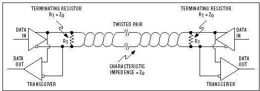

OK, thanks for the help. Please remember, I know nothing about rs485.
Zo is 120 ohms, so I'll need a 120 ohm terminating resistor at both sides.
As for the stubs, those would be the Data Out connections from the twisted wire pair? If so, why would I not just wire the Tx+ and Rx+ together? If not, can you please clarify?
Thanks,
iolly
No, the stub would be the short piece of wire or PCB trace that connects the actual twisted pair cable to the RS-485 transceiver IC. When the connection is just point-to-point between two transceivers as you have shown, it's usually easy to keep that connection short.
BTW, keep in mind that the two RS-485 transceivers at the cable ends should share a common ground. RS-485 is a DC-connected (no transformer) network, so the transceivers have to all have the same ground reference. RS-485 transceivers can tolerate a common mode voltage offset of a couple of volts, but not very many. The RS-485 standard mentions running a 3rd wire along with the twisted pair if necessary, in order to connect the 485 transceivers' grounds.
