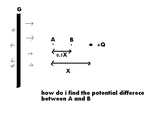

I unploaded a picture describing this situation
i don't know how to find the Potential difference in this situation
because there is two different objects. a charge and a plane.
on the plane we calculate the Potential difference
E*d=v1-v2
on the charge each potential calculates in V=Q/4pi*e0*r
to different things
please help !
problem description
there is an infinite plane whos charge densety is G
on a distance D we put a positve charge +Q
between this charge and the plane there is two point
A and B
point A is distant from the charge in X
point b is distant from the charge in 0.5X
how do i find the Potential difference
between these point?

transgalactic said:
to different things
Yes, they're two different things. However, electric potentials obey the property of linear superposition. That means that you can find the potential difference between A and B due to the plane only, and then due to the point charge only, and then add the results.
