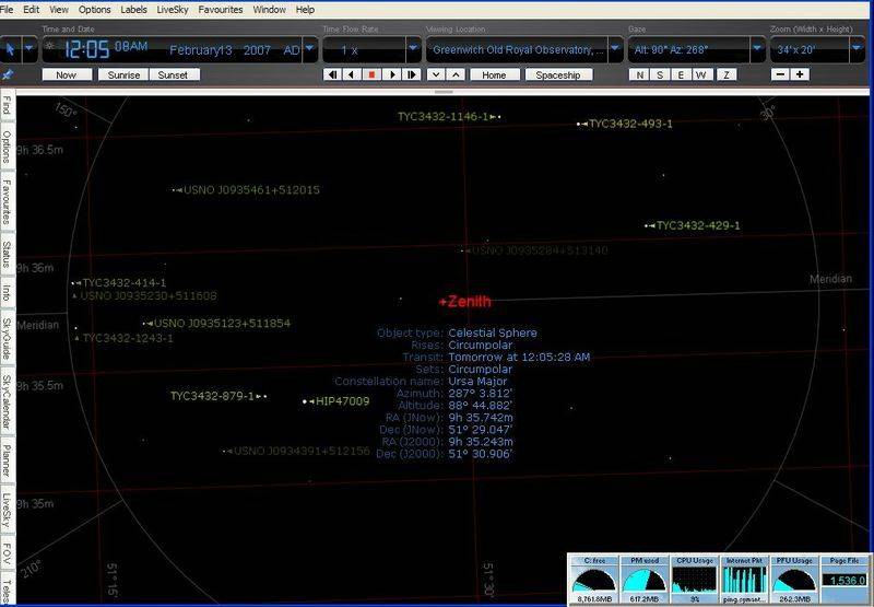

Here's a screen cap from Starry Night. The cursor disappeared when I did the printscreen, but rest assured, it was right on the zenith...
Part of the problem you may be having with the calculation is that there is more than one standard, as you can see in the cap, and the difference is about half an arcmin.
Your screenshot sais, "Altitude 88°". Zenith is 90°, isn't it.
Also, your time zone would be helpful. As is, my test computation results are:
Code:
Date: February 13, 2007, 12:05:08 pm
Julian date: 2454144.95856
Stellarium output /15 (1): 20.5457510321
Yoursky output (2): 20.5457282109
Taking 20h away and converting to minutes:
(1) 32.7450619233
(2) 32.7436926529
neither matches 9h 35.742m, but minutes are within 4m margin, which tells us this error can be explained by different time zone.
EDIT: I took another timestamp 11 hours away, and my minutes became worse:
Code:
Date: February 13, 2007, 1:05:08 am
Julian date: 2454144.50023
Stellarium output /15 (1): 9.51563402541
Yoursky output (2): 9.51561121915
Taking 9h away and converting to minutes:
(1) 30.9380415245
(2) 30.9366731487
:( okay. that's it. now I'm pissed.
EDIT: I have found error it was incorrectly computing julian day. now it is like:
Code:
Date: February 13, 2007, 2:05:08 am
Julian date: 2454144.50356
Stellarium output /15 (1): 9.59585307131
Yoursky output (2): 9.59583026493
(1) 35.7511842786
(2) 35.7498158961
In your screenshot it was 9h 35.742m, so it's a nice match with 2nd value. I will continue to test different codes, but this thread can be considered resolved.
