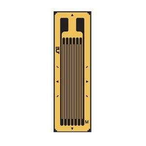

The change in the resistance is for the one wire. When you think of a grid, don't think of a strain gauge grid as a series of boxes. It is one continuous wire that looks like a series of back to back "u" shapes. The gauge is simply a resistor. Each terminal of the gauge is one end of the wire.
Each grid has one orientation that is changing the overall length when a load is applied. In the case of rosettes or stacked gauges, each direction has the same shape, just oriented to each direction.

So in your example image, there appear to be 14 legs of the continuous wire (i'm assuming the solder tabs themselves represent the end of the wire?). In an ideal connection, if I say the transverse strain of the strain gauge, I am essentially saying the transverse strain at any point?
Ok, so, let's say for example, that the image you have attached above is our strain gauge, and it has an active grid of 2 mm by 2 mm. 14 legs make our wire approximately 14*2=28 mm longitudinal, and an additional 2 mm transversely, for a total of approximately [tex]\ell = 30 mm[/tex] (is this a safe assumption?) In our definition of longitudinal strain, [tex]\epsilon_{\ell}=\frac{d\ell}{\ell}[/tex].
If I am looking at a beam for example, that undergoes a change in length of 0.2 mm. Would the new length be
[tex]\ell_{new}=14*(2+0.2)+2=32.8[/tex]
Would that be a safe fundamental and approximate way of approaching it.
Let me also say, I know that just approximating the length of one of the longitudinal legs is generally enough, but i am interested in each one, not just a single one

You'd be pretty good to go about it that way. Although that would be a pretty good amount of strain in a specimen. I do have to say that in common practice one doesn't need to worry really about that since all of your calculations are based on gauge data supplied by the manufacturer. They include all of the information such as gauge dimensions, resistivity info and transverse sensitivity to name a few.
Indeed, I exaggerated those numbers just to pick a random value, I am trying to get an idea for all these basics for "not so common" practice, so i appreciate the help
No problem. You seem to have a good grasp on things.
