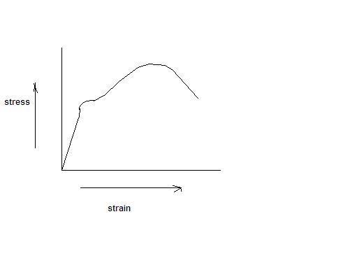

I have a materials question that's asking me to calculate the "magnitude of Luder's Strain" from a bit of low carbon steel that we ran through the machine to break it apart and produce a load-elongation graph.
I know what the region is, the elongated yield point which can be seen on the graph. I just don't know what it is that they are asking for.
When loading a material like low carbon steel, there is a point on the stress-strain (load-displacement) curve where the yield point drops as strain continues. The yield stress decreases from the upper yield value to the lower yield value, and the strain (displacement) continues to increase while the stress stays roughly constant (actually there can be a little fluctuation). At some point, the stress increases as the material continues to strain.
The relatively flat portion of that stress strain curve, i.e. the (yield) extension at the slightly lower stress (lower yield stress limit), is the Luder's strain, and that's the "magnitude of Luder's strain". See figure 1 of - http://fcp.mechse.illinois.edu/reports/FCP_Report040.pdf
Hi,
My teacher told me about the Leuder band concept and said that it is the region on the engineering stress-strain curve between the point at which yield starts till the point when strain hardening begins.
However, I'd like to know in a more generalised way as to how dislocation movement plays a role in each stage of a stress-strain diagram.
I found something called the resolved stress-strain diagram , which has three regions (2nd diagram), but how would one superimpose this onto a regular stress-strain diagram (1st diagram)? For example, does the easy-glide region of dislocation (2nd diagram) represent elastic deformation upto proportional limit?
