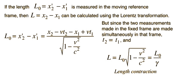

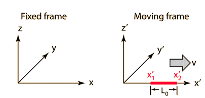

The length of any object in a moving frame will appear foreshortened in the direction of motion, or contracted. The amount of contraction can be calculated from the Lorentz transformation. The length is maximum in the frame in which the object is at rest.
Oh, I know this already, and this problem is somehow different in my opinion, thank you anyway.
