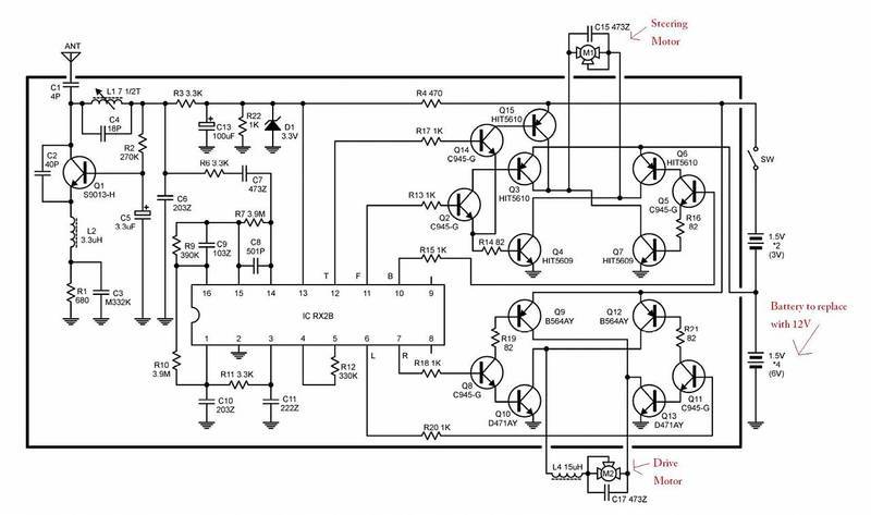

I want to modify a circuit by adding a stronger drive motor.
The circuit is a PCB receiver which is attached to two motors, one which steers a car, one which drives a car.
The previous drive motor needed 2 x 1.5v batteries.
The new drive motor needs a 12V lead acid battery.
This means that 9 more volts will run through the circuit
Here is a block diagram:
Here is the annotated schematic:
I have more information about resistances if there is a need for it.
I am unsure of if the components will still work with such an increase in voltage. So it would be good if someone could advise.
The first problem is that your annotation of steering and drive motor on the schematic is reversed.
The other is that substituting a 12v battery will burn this circuit up.
Some of the components could be reused but major changes are required.
