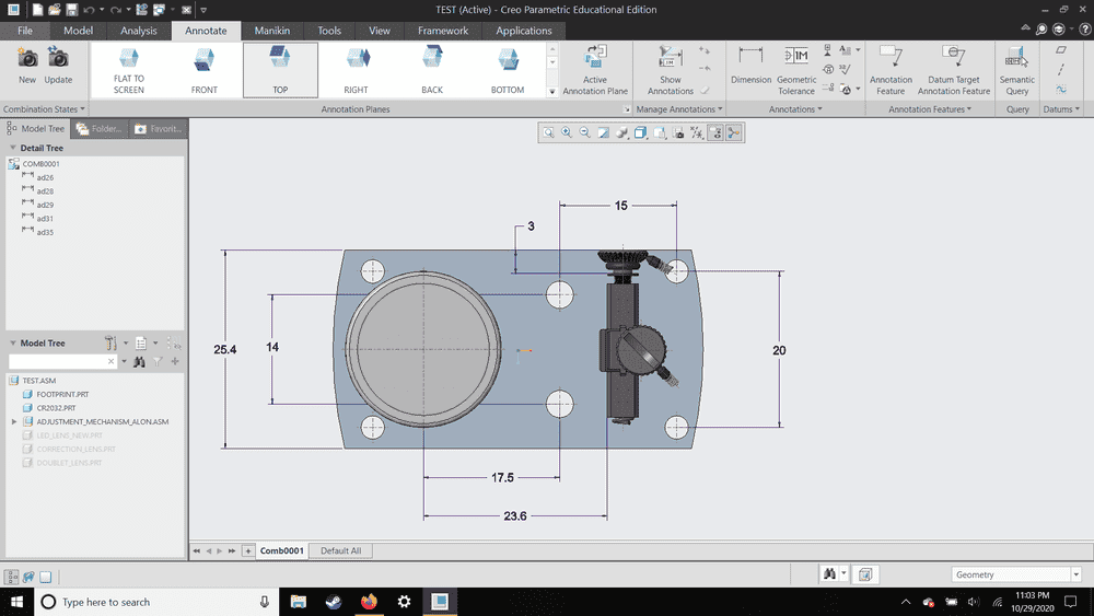

So I looked into changing the 4.7uF capacitor, but it won't actually be necessary. I redid my parts search and was able to find 0402's for all the capacitors and found a 1kOhm resistor for 0201. The sense resistor sadly can't be reduced without changing the the value of it, and I don't know how bright this will be so I cannot make a determination on a better resistance value until the test board is built and tried; but it will likely be increased resistance. So, to sum up the sizes of the parts: the capacitors are all 1mm x 0.5mm, 4.7uH = 1.6mm x 0.8mm, 1kOhm = 0.6mm x 0.3mm, D1 = 1.8mm x 1.45mm, LED Driver = 3mm x 3mm, PSoC 4000 MC = 5mm x 4mm, and RSense = 3mm x 1.5mm. The push buttons will also takeup space on the right side of the device, but I am still trying to determine the right ones for this.
This is this the footprint I am working with. there is a 0.5mm gap under the adjustment mechanism that a board could fit into extend to the far right cavity. The walls of what will house all this are 3mm, which is called out on the head of the screw. But you can see, it is a extremely small space to work in. Every way I think of setting this up, it doesn't appear to fit. Like putting the LED Driver in the right cavity, but it requires all its components (except MC and LED) to be in very close proximity, but it looks like there isn't enough space for that when you include the mount sizes. The MC would barely fit, if at all. And both of them cannot fit on the left side.

A trick for figuring out tight layouts is to draw a footprint of the available space at 5x or 10x scale. Then do a cutout of each component at the same scale. You then have a jigsaw puzzle to play with and figure out what goes where.
When you realize you need a double-sided board, the footprint can be on a clear plastic sheet, such as a notebook page protector. The drawback of double sided is you will need an adhesive on the components, something like a double-sided version of "Scotch" brand Post-It tape that is readily removable.

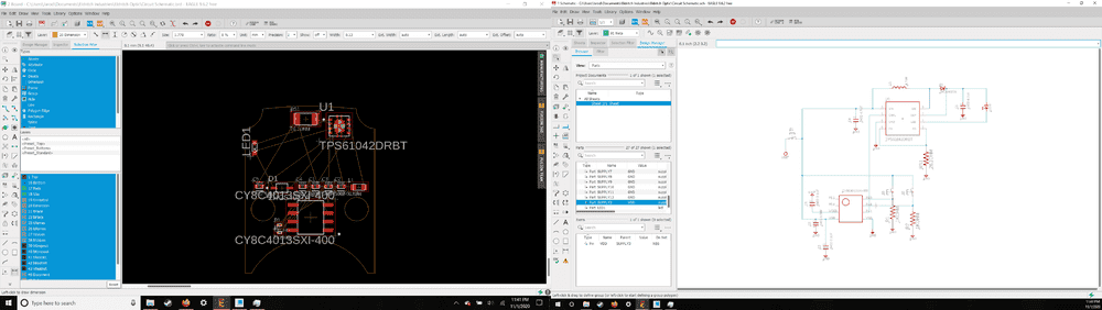

I appreciate all the help you, and everybody else has given me to get to this point! I finally got the PCB shape with the parts footprints into EAGLE.
It seems to fit at a rudimentary level, still have to connect everything. But before I can do that, I do have some last questions on connecting and doing things. So the LED is a bare die with a P and N contact plate that will be wire bonded to a separate PCB mounted on the "floater"; how do you create a footprint to have two separate but connected wires running between the PCB's? This also has to be done for the silicone rubber buttons on the left side of the board. Is there a specific term I can lookup to find a footprint done on SnapEDA? And lastly the battery will be connected with a contact strip similar to the one shown here: https://patents.google.com/patent/US6327806?oq=reflex+sight. Except instead of going all the way to the LED mount, I just need to connect it to the main PCB. Is there some sort of standard to do this?

It is difficult to "see" from reading text. What struck me was the word wires doing the connection between two pcb's if I resd it correctly. I've been taking things apart since I was a kid to see how they are put together, most times to see if I can fix something that broke. Wires are always a problem if they are flexed either during construction or use. If you are connecting two boards, spring loaded contacts might be best approach. I've seem some tightly packaged devices use thin cardboard to isolate components from metal surfaces and each other. So if there is some danger to the rest of the board , you can cut slots in the cardboard for the clips. You should be able to find clips that mount to a PCB and go from there. I hope I understood the problem correctly.
The term wires was a rough term I used because I don't know exactly what it would be called. This is what I am thinking of using to connect them: https://www.google.com/search?clien...le&aqs=mobile-gws-lite..#imgrc=msOltaLryb9VIM. I don't know the name of these or if they have a standard footprint. But these seem ideal since it would be flexible to connect to the other boards while also being bonded between the boards.
As for the cardboard suggestion, the PCBs don't need to be compartmentalized, the problem is the main PCB in the picture is flat on the bottom of the device. Another PCB is perpendicular to it and mounted on the "floater" which moves. The other PCB is also perpendicular to the main PCB and the floater PCB. Both of those PCBs have to connect to the main PCB. And lastly the contact strip has to connect to the main PCB. That's the problem I'm struggling with; if I can just get over this hump I should have enough of an understanding to make the prototype, test it and refine it based off of the performance.
