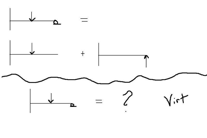

How do you go about solving an indeterminate beam for various deflections by virtual work? I'm kind of at a loss right now and can't proceed on my homework. I've attached a picture showing the problem I'm confused on - I don't know how to go about modeling the virtual model so I can find the moment diagram and integrate. :(

You must draw bending diagram (moment) of force for each "force".Then you can say that deflection of B is zero. The deflection of B is caculated like this:
Area of moment diagram from outside force x height of diagram in place of centar of gravity in second diagramx1/EI.
I-momentum of inertia, E-Young's modulus (E)

That's not solving by using Virtual work, and according to what you said looks like using conjugate beam.

Simply write first the compatibility equation, and find the deflections on the primary structure by using virtual work and find the flexibility coefficients by virtual work, too.
For your case there is 1 compatibility equation of the form (considering deflections down positive):
[tex]\Delta_{end} + P_{end}f_{end} = 0[/tex]
Heh - I figured it out. I had to solve it three different ways to show that virtual work can be applied to any indeterminate structure released to a stable state (i.e. if there's n degrees of indeterminacy, you can release n reactions/supports to make it a determinate structure). :) Thanks for the help!
