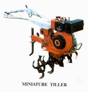

Small Diesel engines do exist. Take for example, this roto-tiller:
http://www.minelinks.com/tools/diesel-tiller.html

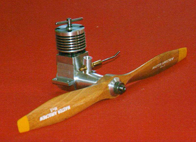

1-2 cc compression ignition models are popular for modelers e.g.:
http://www.modelenginenews.org/mate/index.html

Look at the rototiller you mentioned, it weighs just 70 lb with all the equipment.

"Real" diesel cycle R/C aircraft engines do exist in that they use compression-ignition; however, it seems that they don't run on diesel fuel, but rather a high ether content kerosene. Looking around briefly, I was unable to find an R/C engine that actually runs on diesel fuel.
rc-airplane.world.com said:
Diesel engines are another choice but are the least common out of all the IC engines.
Diesel model airplane engines, such as the PAW shown right, are typically used in vintage rc airplanes to keep the model as traditional as possible.
Such engines were being manufactured before glow plug technology, and so were the first IC engines to be used in radio control flying.
Diesel engines do not use any form of plug for ignition, but instead rely on the fuel/air mixture inside the combustion chamber to ignite from the friction heat generated by the piston moving up and down as the prop is flicked over to start.
The pressure inside the chamber can be increased or decreased by turning a threaded screw on top of the cylinder head; increasing pressure aids ignition of the fuel/air mixture. The fuel is a special mix that has a high ether content, which is easily ignited.
Those helicopter engines have got to be more powerful for the same weight of aircraft, that's why it must be the place to look for a big model engine. Looking for the lightest available engine for a 1-3 kW generator. The engine NateTG mentioned seems to run on actual diesel fuel:
"It was produced for more than 10 years and sold here in Oz and in the USA (where it even comes with a nice little can of diesel fuel!)"
So who makes a bigger one of those?
The page does say it runs on Diesel fuel, but I'm not sure I believe it. If it did run on diesel alone, without any additives, it would be a very rare engine indeed. Also, that particular engine was a custom engine people built in their at-home foundries according to the article...
