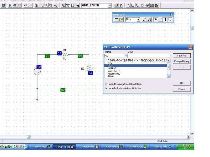

when i connect a sinusoidal voltage source to resistors all voltages and currents become zeros.
another problem is how to plot the voltages and currents for any component.
if anybody has a book or link it would help please reply. thank you
check the attached picture
Looks like you haven't defined an amplitude for your source...
