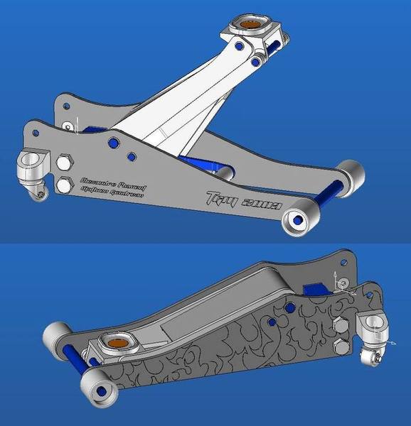

Here's where I'm at with this..
Looking good! :approve:
very impressive! Did you design that yourself from scratch or did you take dimensions from existing floor jacks? I like how low-profile it is. The floor jack I currently have is too tall to fit under some smaller Japanese cars - got to grab the fender and lift the body to get the jack under :)
nice autocad draw

Thanks!
I looked at a similar jack they had at CanadianTire (which is discontinued) and based it off that one. We decided to make it lower and correct all the defects that it had.
We're also using all aluminum and stainless steel parts. The only steel part are the 4 bolts that hold the pump and all the circlips.

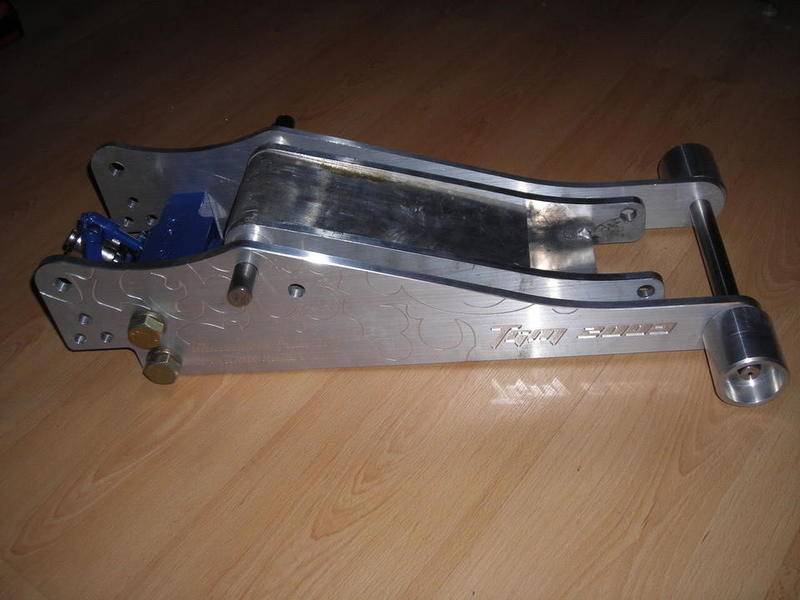

Here's a little update after I cleaned it up a bit.
it looks really good. I am pretty sure it will fit in my low honda del sol!
That's a very sweet looking piece of equipment, old bean.
What did you use for the engraving? (Or is that applied vinyl for the graphics?)
It's all engraved with a #5 Center Drill, except for the TGM 2009 which was done with a 1/8" End Mill. There's my name and my partner's name on the side. TGM stands for Technique de Genie Mécanique (Mechanical engineering).
I painted over everything then sanded it off and polished the aluminum.

Were the drill and end mill computer controlled, or did you do it manually? In any event, it looks terrific. It's rare to see great engineering and art combined so well. :approve:

Right right, I'm just not used to hearing that expression. Not all Quebecers have a french background.. obviously I do though :D
Everything is computer controlled

Mostly done :D
Specs:
- Two pumps to reach maximum height (with no weight on it)
- 2.6 inches of clearance when lowered
- 18 inches maximum height
- 1.5 tons maximum lift weight
- Materials include Aluminum, Stainless steel and 4140 Steel
Everything made by me and my friend of course.

Like any good piece of equipment, that thing looks even better in use than it did just sitting there. Congrats on a great project.
