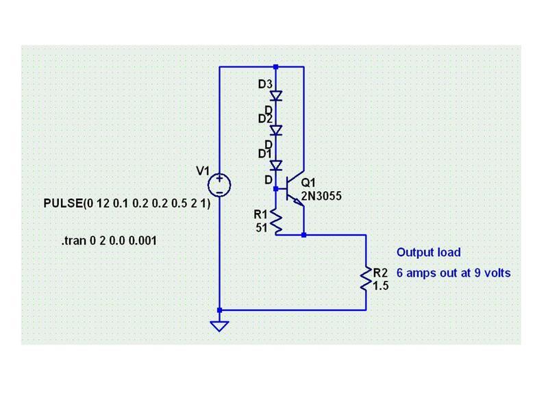

Here in thumbnail is a regulator that produces a relatively constant 3 volt drop for different loads and different input voltages. The 2N3055 is rated at 10 amps collector current, and needs a sufficient heatsink for 20 watts.
Bob S
