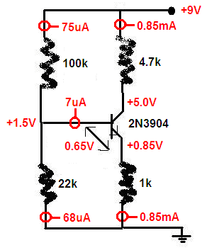

could some1 explain it entire circuit in terms of electron movement i.e how the voltage drops in each component in terms of electron flow
1)i can't understand the voltage divider bias i find it extremely difficult
please explain it interms of electron movement in anyone of the circuit diagrams mentioned below (explain the voltage drops for the electron current
2)also to be frank i can't understand what basically Vbe and Vce is
is it the barrier voltage between base emitter and base collector respectively
if so then how can voltage drop occur at CB junction
it experiences no impedance and only attraction then how can the voltage drop there
what is meant by emitter base juction has less resistance and collector base junction has high resistance.But actually electrons from emitter get attracted to the collector easily how come that region has high resistance
i have posted the circuit diagram
i have many doubts there about how the voltage drop between R1 and R2 gives forward bias to the base emitter
also which current's voltage is getting dropped there
in my diagram its showing collector current
but collector current itself arises from the emitter
also u have not biased the emitter till now then how did u get Ic
forward bias provided by the voltage drop of Ic
see u have not biased it and u r about to bias the emitter only from voltage drop of Ic
then where did u get that Ic from
Ic comes only after biasing EB
so could some1 explain the entire circuit qualitatively in terms of electron current starting from the ground please don't explain in terms of conventional current. I want only electron flow
i want to know how can the voltage drop cause forward bias to the base emitter

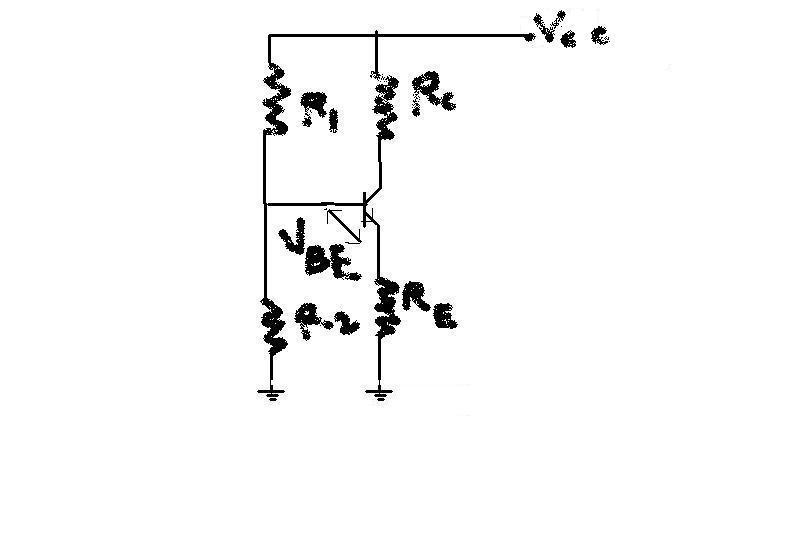

Voltage divider bias
please can any1 explain in terms of electron movement i.e how direction of electron flow
and how a voltage drop can cause a bias i am totally confused and can't understand it
because it is necessary for me to understand single stage ce amp
i have provided the circuit
Is it that you are having trouble understanding how a voltage divider works (not likely), or how BJT bias works for CE amps? What can you tell us so far about how a CE BJT is biased? What does your textbook say? Does the wikipedia introductory article help?

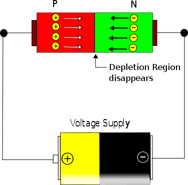

i have a serious doubt about biasing a pn diode and npn transistor
first i'll mention about pn diode biasing
the basic doubt i have in pn diode is that
during forward bias + is connected to P and - is connected to N (+terminal -terminal)
what i read in hyperphysics is that the electrons in N type cross the holes and go to the positive terminal and equal electrons from negative terminal flows to the N type again
in this way the diode forward bias explanation is convincing
but what i read in this site
http://www.tpub.com/content/neets/14179/css/14179_32.htm
is that the electrons first start from the negative terminal and go to N type and cross barrier potential and go to p type and go back to positive terminal
in the latter explanation the pn junction is not anything special
it is just like a ordinary small resistor dropping .7 volts.
but the latter explanation is used everywhere even in rectifier they say diode does not allow current to pass from the battery in the other direction and allows the current to pass through it only in one direction
then what is the use of inventing it calling it electronics devices
nothing special is happening because no1 is explaining in terms of what is first happening in diode(my first explanation from hyperphysics).
everywhere they are explaining in terms of electrons or current coming from the battery
i want to know how rectifier bridge rectifier works i.e starting from the diode and not from supply. because if we start only from the diode we can say its electronics
if we simply start from the supply its none other than simply electrical
I have the same doubt in npn transistor which i will mention in the subsequent posts
please some1 clear my doubt

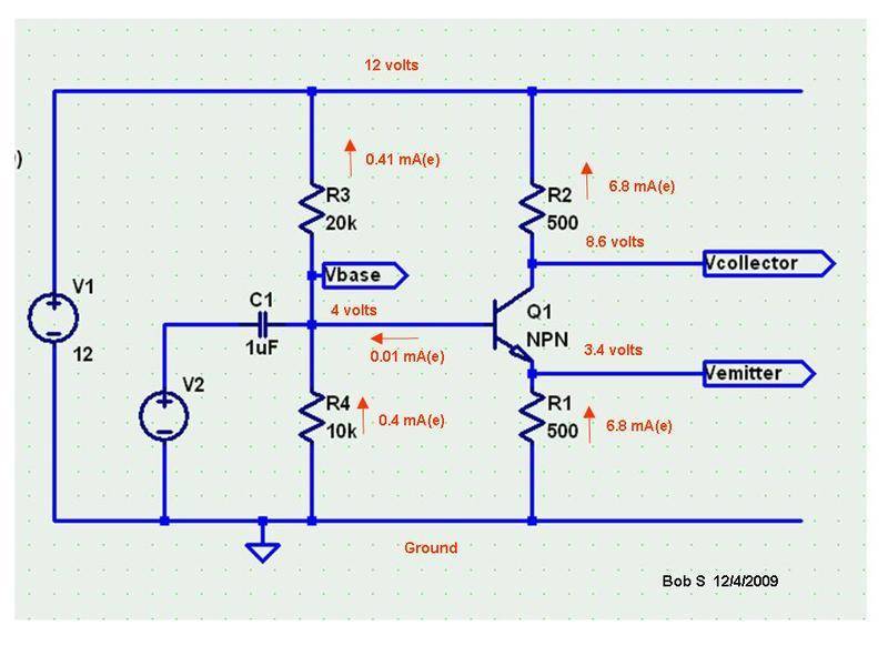

Sudar-
Please refer to the two attached thumbnails, and refer to them when asking questions. The first one shows the quiescent voltages and electron(e) currents for an npn emitter follower circuit with a collector resistor. The second thumbnail shows the base, emitter, and collector voltages when a 1-volt peak ac voltage is applied to the base.

1)What is V2 and V1 in the figure?
2)Also you have marked 4 volts to the base,but actually the 4 volts gets dropped and the electrons have 8 volts (12-4) remaining at the base.
3)You have calculated the values for conventional i.e u have marked 12v at the top and 0 at the bottom, but actually if we consisder electron flow 12v must be at the bottom and 0 must be at the top.
4)V emitter must be 8.6 (12-3.4) 3.4 is the voltage dropped.
5)Also electron current through R2(500 ohm) must be .016 i.e 16mA ( 8/500=.016=16mA)
8 volts came from 8.6-.6 (.6 is the barrier voltage).
6)BOBS i have calculated all the values taking the electron voltage to be 12V
but i can't type it in 'microsoft paint'.
7)Why that capacitor is used? What do u mean by coupling, i want a detailed explanation on it
8) What is Vce , there is no barrier voltage extending from emitter to collector then what do u mean by Vce .Also what is Vcc ( in CE configuration)
9)Also my most important doubt .
From where does the electron flow start?
From the supply Vcc or from the emitter ??
If the latter then the 12 V electrons starting from the emitter drops .6 in the depletion region then 8.6 V in R2,but it has to drop all the 12v
please clarify this
dont mind about the points 2 ,3,4,5 mentioned by me .I'll take care of it.
But please clarify point 1 ,7,8,9
Thanks BOBS for ur efforts and understanding my difficulties.:approve:

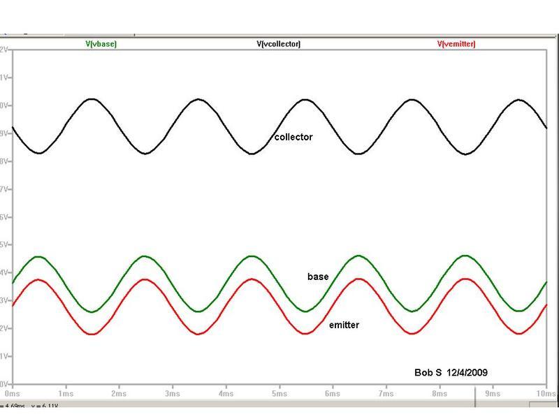

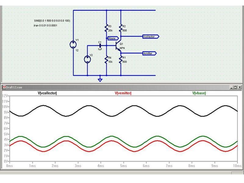

p.s Also if u consider the electron flow movement then in the graph Vemitter must be above than Vbase
1) V1 is a 12 volt dc power supply. V2 is a 1-volt peak ac sine wave power supply. It is ac-coupled to the npn base.
2) I am measuring the volts above ground. This is very much like a cathode-bias vacuum tube triode: cathode= emitter; grid = base, and plate = collector; same voltage scheme.
3) Electrons flow from the bottom to the top just like vacuum tubes.
5) Current through R2 is 3.4volts/500 ohms = 6.8 milliamps.
7) Capacitor is used so as not to disturb the dc operating point of transistor.
8) Vce just means the dc collector-to-emitter voltage. In this circuit, Vce = 8.6 V – 3.4 V = 5.2 volts.
9) Electrons start at ground, flow through R1 to npn emitter, out the npn collector, through R2 to + 12 volts.
ps) The base current (electrons) flow in the emitter and out the base.
I hope this helps.
