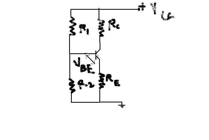

my first doubt is
what is meaning of Vbe base emitter voltage
and also Vce collector emitter voltage
what is the actual meaning of these 2 voltages
i can't visualize
also are these voltages permanently there

In this thumbnail
https://www.physicsforums.com/attachment.php?attachmentid=21960&d=1258770808
the plot at the bottom of the thumbnail is voltage (vertical) vs. time (horizontal). The green curve is the base (input) voltage, red is the emitter voltage, and black is the collector voltage. Vbe means base-emitter voltage, and Vce means collector-emitter voltage. Note in the circuit diagram that the collector current is nearly exactly the same as the emitter current (both across a 500-ohm resistor), and the base current is very small.

sudar_dhoni said:
1) i asked what is the physical meaning behind Vbe and Vce
is it the barrier potential
Vce is the driving potential for the amplifier.
Vbe is the bias potential across the base-emitter junction.
Both are applied to the device, and are not inherent properties of the transistor.
Hi Sudar-
I will try to answer your questions. First, study the figure
Power supply V1 is 12 volts. The base bias voltage is 1/3 of 12 volts, or 4 volts. So the emitter voltage is 0.6 volts less, or 3.4 volts. So the emitter current is 3.4 volts over 500 ohms. or 6.8 milliamps. The collector current is also about 6.8 milliamps, so the voltage drop across R2 is about 3.4 volts. So the collector voltage is 12V - 3.4V = 8.6V. Power supply V2 is ac coupled to the base. It has a 1 volt (peak) 500 Hz sinewave on it, and on the base. In this configuration, the transistor is an emitter follower, so all three sine waves (base, emitter, collector) are about 1 volt peak. I hope this helps.

1) i can't understand the basics
i want to know what do u mean by voltage between emitter and base and voltage between collector and base
is it the barrier voltage ?
i.e the barrier potential at the juctions EB an CB?
the depletion region is responsible for the voltage drop in diode
in forward bias also there exists voltage drop according to my book
but in forward bias the depletion region would have vanished,then how will there be voltage drop.
2)also i can't understand voltage divider bias
i have posted the circuit diagram
i have many doubts there about how the voltage drop between R1 and R2 gives forward bias to the base emitter
also which current's voltage is getting dropped there
in my diagram its showing collector current
but collector current itself arises from the emitter
also u have not biased the emitter till now then how did u get Ic
forward bias provided by the voltage drop of Ic
see u have not biased it and u r about to bias the emitter only from voltage drop of Ic
then where did u get that Ic from
Ic comes only after biasing EB
please BOB S answer first question 1 and then 2

  • Circuit schematic of a common-emitter NPN transistor amplifier with voltage divider bias: R1 from supply to base, R2 from base to ground, RC from supply to collector, RE from emitter to ground, with VBE and VCE labelled.
