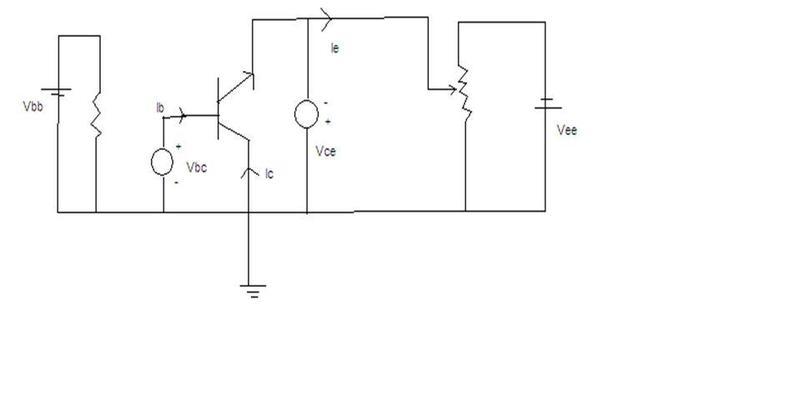

1. In common collector configuration (CC)of NPN transistor,there is a battery (Vce) connecting the collector (C) and emitter (E) which makes the C positive and the E negative due to the polarity applied...and there is another battery (Vbe)connecting the base(B) and E...which forward biases the B-E junction (am I okay till now?)
Now,this is exactly the same as the CE configuration..so the electrons must flow in the same way in this configuration (CC)as in the CE ,and the magnitude of the current must vary in the same way on varying Vec and Vbe as in CE...so where's the difference?
Also,I have noticed that in all three possible configurations,the B-E junction is forward biased and the C-B junction is reverse biased...then what differentiates them?
2. When we say that the 'input voltage' is through the base and the 'out put voltage' is through the Collector in the CE...and this results to voltage amplification...what exactly do we mean?
(As I said,in all configurations,in all three possible configurations,the B-E junction is forward biased and the C-B junction is reverse biased,so what allows to get different output voltage amplifications and different output characteristics in the three configurations?)

Thankyou sooooooo much sophiecentaur for your reply,after waiting eagerly for so long!Please hang on with me till I get my fundamentals clear...even my teacher doesn't have her fundamentals clear!
I read through your post...and there are some places I don't understand..please clarify these before I proceed any further...
sophiecentaur said:
Remember, the transistor doesn't 'know' what circuit it's connected to - it just has volts and currents supplied to it and behaves according to its characteristics.
See,I don't understand,in the first place,how we feed a current into the transistor...for example,in the CE configuration,the base current is the 'input current'...but it's flowing out of the transistor...so how can we input the current through the base?
Also,what do we mean by the output of the transistor...is it a voltage?...how do we use this output?

Current flows from the positive bias on the base through to the emitter, which is 0.7V lower in volts.
A transistor doesn't know, explicitly about "ground". How can it? You can connect just one of its terminals to a fixed voltage - it could be Earth, +6V, -9V or anything, To make it operate you need to ensure that Vc is positive wrt Ve and to make Vb appropriately higher by appropriate resistors etc.. Under those conditions it will behave like a transistor - letting current go through (c to e), according to the base current value and its 'current gain'..

Hi sophiecentaur,I'm reading through your posts over and over again...I think I'm slowly getting it...however,in the mean time,if youcould just elaborate on certain points...(sorry to bother you like this..I'll try to get through this as quickly as possible)...
1.The basic biasing of the different junctions (forward bias on the emitter-base and reverse bias on the collector base junction) seem to be the same in all configurations,but,as you said,we obtain the required results by just changing the locations of the resistors,and the batteries...now what I don't understand is as to why we have to change the locations of the batteries (I mean connecting a battery betweenC -E in one config.,and then connecting a battery between C-B in another) (since the batteries are only responsible for the biasing,which is the same for all the congigurations)when changing configuration...since if we only change the locations of the resistors(which are what give us the output),we would get what we want.
2.When we input the current through different terminals in the different configurations,though the biasing is essentially the same in all configurations,the input current seems to undergo different situations in each config.,leading to different output characteristics...how do we explain this?
3. In a CE amplifier, the voltage we 'see' on the collector is due to the current which flows through the load resistor and as the Base volts go up, the base and collector currents go up. Hence, the PD across the collector load goes up and the value of Vc goes down further relative to the positive supply - it's an inverting amp...I've understood this.
What I need to clarify is,even if the net potential of the battery Vce goes down,w.r.t. ground,does it still have the same effect on the biasing of the C-B junction?
Also,in this case,the net potential drop across the collector resistor is reduced...how does this help us in practical purposes?
Please don't get fed up with me! I promise I'm trying hard to understand this..I'll do it as quickly as possible.
Hi
1. You don't have to connect a battery directly to a transistor anywhere - see the complete amplifier diagram in that Wiki link.
2. The input is made to vary in all configurations and will always produce the same current flow (assuming Vce is sufficient).
3. You don't "bias the cb junction". You bias the be junction. If the battery volts go down then you have just changed the operating conditions so I'm not sure what you mean. IF the battery volts drop as result of taking more current (a bad battery), this is the equivalent of having a higher value of Rc - so the overall (small signal) voltage gain will increase. If you just use a lower voltage battery, the small signal gain will stay the same BUT the available range of possible voltages that the collector can attain (voltage swing between transistor 'off' and transistor 'hard on' conditions) will reduce. This is very relevant at times - if you need the circuit to handle 'big signals'. (I have hearing aids with lots of gain but working off a single cell and it's output power is V. low "What? speak up I'm not deaf young man!" howl squeak) Power Amplifiers use higher voltage supplies for this reason. If you try to design an amplifier to work at 12V (automotive applications), you need to have transistors which will handle large currents to make up for it. But that is another story.

Please confirm if my conception is correct in the following statements..(it'll do if you just say 'yes' wherever you think I'm okay,and if you just tell me where I'm wrong in the rest.)
1. Due to grounding, the current in the common terminal is taken to the earth,so we don't need to consider that current (like in CB,the base current isn't analysed,since it is taken to the ground).
2.The net potential across the output (load) resistor is what determines the output voltage.
(in CB,the net potential across the collector decreases from the original value of Vbc applied to it ,also the output current through the collector is less than the input current through the emmitter…whereas in CE,the output current through the collector is larger than the input,and the net potential across the collector decreases from the original value of Vce applied to it)
3.As I said before,the net voltage across the output/load resistor is what we call as the output voltage...in order to use this net potential,do we connect a resistor in parallel to the load resitor,so that we get the same potential difference across this parallel...which we could perhaps use for some practical application.
4.In CC, as we increase Vcb,the input current (Ib) has to decrease due to increase in the thickness of the depletion layer in the C-B junction.(input characteristics of the CC)
5.In CC, the output current Ie attains a constant value after reaching a certain Vce (for fixed Ib),as the forward bias across the B-E junction cannot be increased any further by increasing Vce.
Just three more questions to get things clearer..
1. Why,in CC configuration,is the voltage gain is less than one (it says so in my book...is this wrong?)?
2.You said in your previous post that 'You don't "bias the cb junction". You bias the be junction.'..but I thought we change the reverse bias of the C-B by changing the Vcb (like when obtaining the input characteristics of the CC configuration)
3.In CC or CE,increasing the Vce increases the forward bias across E-B,so automatically,the Ib increases...but then the input current itself changes! Are we really supposed to allow the input current to change?

Hi,
I've been reading through your posts and I sort of think I'm getting it. Yesterday,I tried to think for myself,according to the basic principles that you mentioned,what exactly goes on inside each of the configurations,and tried to predict what the input and output characterisitics could be...I suppose was right in atleast some cases.
The thing is,even though my first priority is in understanding my basics,I've got an exam on Monday,and I've got to understand the other stuff for it too.
Anyway,coming back to the main issue,
I wasn't really saying that Ib doesn't matter in CB,actually I was asking that since it is not used in either the output or the input,it is taken to the ground...ofcourse,I realize that Ib has to be there,else the transistor wouldn' run!I hope that's okay.
Also,please tell me if I'm right in saying that the net potential across the load resistance is what we consider as output voltage.
I was thinking,that to put this voltage into use,we would connect something in parallel to it,and we would thus get the same potential drop across this parallel device.
Personally,I found the CB configuration easier to understand,since initially I was confused about how we could connect a battery directly between C and E in the CE and CC configurations...but that is not there in the CB...am I wrong somewhere?
Again,as I said,since,I tried to figure out what is happening in each of the configurations on my own,I analysed and came up with the following.-
1.in CB,the net potential across the collector decreases from the original value of Vbc applied to it ,also the output current through the collector is less than the input current through the emmitter
2.whereas in CE,the output current through the collector is larger than the input,and the net potential across the collector decreases from the original value of Vce applied to it)
3. In CC,the net potential across the emitter load is also less than the applied Vec...so the out put voltage will again be less than the applied voltage to the emitter.

That description doesn't actually make sense. You say you have a battery to establish Vce but you also have an emitter resistor? So the transistor and resistor 'share' those battery volts, according to Ie.
Then there's a battery to establish Vcb (forward biasing the cb junction; do you really mean that?) - and again there's a resistor in the base; its value is relevant.
I'm very confused. Can you do a picture? Or do you mean it's the same as in the 'monash' link and you have described it oddly because it's a CE amplifier ?
Are you actually quoting your own measured results? If the Vce /Ic lines are horizontal it's because the transistor is working 'well' with the collector behaving as a current source. Look at some published transistor characteristic curves, too.
I still think you are confusing causes with effects.
I've been trying hard to send you a picture,but the drawing,in 'paint' is too large to send on physicsforums(that's what it keeps saying..my file is 585Kb,whereas the maximum size is 300Kb)...what should I do?
Send the picture as a JPEG of the appropriate size. There'll be no problem with resolution.
I have no idea as to how to do that yet...I'll try,though...in the mean time,I feel a better description of my circuit could be given as:
a battery Vbb with positive terminal at B,and the other end grounded(since the collector is grounded),a battery Vee with -ve on E and the other end grounded...there is a variable resistor between Vbb and base,and one between Emitter and Vee.
(Vbb provides the potential difference between Band C(Vbc) and Vee provides potential difference Vce between base and emitter.)
I got this idea from a website,so please forgive me if this description is even worse!
You can do a screen shot in Windows can't you? Then crop it and send it.
I can't make any sense of your verbal description. Is this transmitter NPN or PNP?
I do wonder whether you are making the best use of your time with this when you could be discussing and learning something more relevant to transistors.
Give us a link to that site, perhaps.

I did it!...here's the picture...
  • #35
That diagram doesn't really make sense, does it? I assume that the isolated battery / resistor on the left are actually connected to the base - but that is not the problem. Why not draw the diagram the 'right way up' like the circuit diagrams you can see everywhere else? Are the circles meant to be Voltmeters? The standard is to put a V inside the circles. Are there any ammeters in circuit?
You are wiring the device in a very strange way - the actual values of your resistors are very relevant. You appear to be connecting the base to a positive voltage and the emitter to a negative voltage. In this arrangement it is possible to connect positive supply directly to negative supply via the be junction - owch! - they should never be more than 0.7V. The controls of your parameters are not independent but will affect each other. The bc junction seems to be forward biased (?) or where is 'Earth'?
Don't forget that the transistor was developed to be used in a certain way to act as an amplifier. Is there any point in trying to use it in another way, unless you really have a clue about what's goig on? It's just a good way of getting null results or cooking transistors.
I suggest that you look at websites which can advise you on how to measure transistor characteristics (Google "Measure transistor characteristics", for example) and get all that sorted out before you embark on your own investigation. Random measurements like that are very unlikely to be very fruitful or advance your understanding.
You still haven't given the link to this website you say you have looked at. If you are following what it says then I suggest it may be doing you more harm than good.
This thread is really going nowhere now, is it? I thought, originally, that you really wanted to further your knowledge and understanding of transistors. I have my doubts, now.
