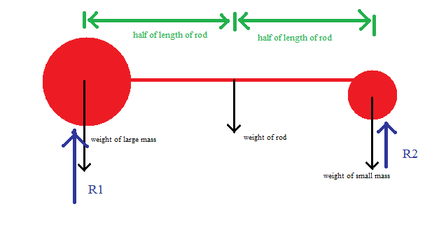

There's a rod, 1 m long and by itself weighing 1 kg, with two balls attached at each of the sides, one weighing 2 kg, and the other 4 kg. The balls are put upon two scales. What force is applied upon each of the scales (e.g. what do the scales show)?
This is a problem that I'm trying to resolve not putting exact numbers to it, but just mentally to get to see how the forces work. So right now I don't have any equations to operate with.
I was thinking each of the scales would show at least the weight x g of each of the balls. What I'm having problems with is how much of the weight of the rod would "show". Would I be correct in assuming that I need to find the center of gravity of the said rod (when the balls are attached to it) and then add the weight (force of gravity) of the rod, left and right of the said center, to the respective scales (weight of the rod's part left of the center to the left's ball weight and the rod's part right of the center to the right ball's weight)?

I was thinking of something along the lines of:
2kg . y + (y/1m) . 1kg . y/2 = 4kg . (1m - y) + ((1m - y)/1m) . 1 kg . ((1m - y)/2),
where y is the distance from the ball that weighs 2kg to the centre of gravity of the whole system.
I tried equalizing the leverage of the left side to that of the right side, but don't know whether that's the right approach.
I would draw a diagram like the one I've attached (mspaint, sorry :) putting in the numerical values that we know (instead of the words I have). R1 and R2 in this are your unknown 'reaction' forces - they are the forces exerted on the bar + balls, which will be equal and opposite to the forces exerted on the scales by the balls (by Newton's 3rd Law).
We need two equations; we can get one of these by noting that if the whole thing is going to stay stationary, then the sum of the forces upwards must equal the sum of the forces downwards.
The other we can get by taking moments ('equalising the leverage', if you like).
EDIT: Kind of like the equation you wrote above, yeah. To make it easier on yourself though, you can consider the weights of the different components separately, and take moments around any point you like. Then you don't have to worry about where the centre of mass of the whole assembly is.
Can you do that? :)

I'll call our 'reaction' forces from each scale [tex]R_1[/tex] and [tex]R_2[/tex]. Since if we take moments about a point that a force passes through, we get an equation without that particular force in it, I'm going to make two equations by taking moments about the points at which each reaction force acts on the ball. So firstly, for the left (bigger) ball, we're going to get an equation that says:
moment from weight of rod + moment from weight of small ball - moment from R2 = 0
Notice the minus sign, since the force R2 acts in the opposite direction to the others. Using the numbers you gave originally, noting that force due to gravity is 9.81 ('g') Newtons per kilogram of mass, this gives:
[tex]9.81 \times 1kg \times 0.5m + 9.81 \times 2kg \times 1m - R_2 \times 1m = 0[/tex]
Rearranging and solving for [tex]R_2[/tex] gives:
[tex]R_2 = 9.81 \times 2.5 N[/tex]
Doing exactly the same thing on the other side (moments around small ball) gives:
moment from weight of rod + moment from weight of large ball - moment from R1 = 0
hence:
[tex]9.81 \times 1kg \times 0.5m + 9.81 \times 4kg \times 1m - R_1 \times 1m = 0[/tex]
so:
[tex]R_1 = 9.81 \times 4.5 N[/tex]
Now consider our scales. The forces acting upon them are equal (by Newton's 3rd law) to R1 and R2. If they give a reading in kilograms then we are going to lose the factors of 9.81 above, so the scale under the heavy ball will read 4.5kg, and that under the light ball will read 2.5kg.
Notice that these add to 7kg, which is the mass of the whole system, as we would hope. :)
