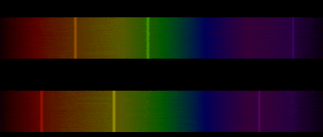

To illustrate what Nabeshin is talking about, check out the attached image. It shows an un shifted and shifted spectrum. The bright lines are the emission lines for an element. Note how they move towards the red end in the bottom, shifted spectrum.
Reddening of the light due to cooling would result in the spectrum being dimmer at the blue end, and thus looking redder overall, but the emission lines would stay where they were.
