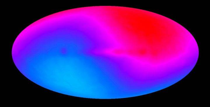

Sure, or even just moving at constant velocity. If you are locally at rest with respect to the CMB (comoving with the expansion) you will measure a uniform temperature (modulo intrinsic anisotropies on the order of 1/100000). Now, if you are moving relative to the CMB, then the CMB photons in front of you will be blue shifted relative to those in the back, leading to a temperature profile like this:
This "dipole" anisotropy is still small relative to the average temperature of the CMB. For the Earth, moving at around 625 km/s relative to the CMB, it gives an effect on the order of 1/1000.

bapowell, it seems that this gives meaning to "absolute motion." Intuitively, I would have thought that the apparent source of the CMB would have shifted slightly for the "moving" observer, making it appear as homogeneous as for the "at rest" observer. Has the "dipole anisotropy" been observed experimentally and reliably? If so, then this is a pretty major revelation for me.
John Bleau said:
Has the "dipole anisotropy" been observed reliably and experimentally?
Sure. The picture I included above is the actual dipole as seen by NASA's COBE satellite. However, we're still not talking about 'absolute motion' -- the CMB merely serves as a convenient frame of reference. Research "CMB dipole" or any of the CMB experiments (COBE, WMAP, etc) for more information.
