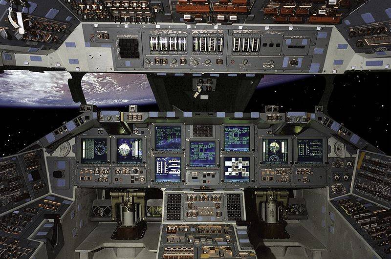

I've been wondering for quite some time now how aircraft work. I'm not talking about the aerodynamics of flight, I mean things like, how the aircraft's flaps move when a pilot commands them to using the yoke?
I've also wondered how the digital displays, such as the ones in the photo, work.(this may be an electrical engineering question)

The top picture is of a Boeing 787 and the bottom one is probably a space shuttle. Both works differently by the way, in many aspects.
