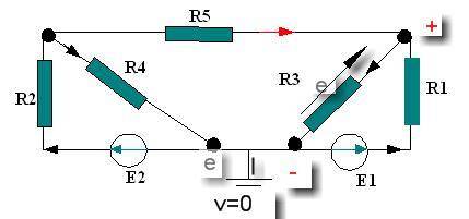

as what 'what' said:
The potential difference is defined as a path-integral of a charge moved in an electric field from point A to point B which produces a simple potential difference
and from this to definitions i can tell you exactly what i mean:
when i attach the node to ground i had zero voltage in this node . physically
the electrons must go from the smaller voltage point[tex](v_{ground}=0)[/tex] to the biger voltage(upper positive point) > how this works , or is this way of thinking is wrong?.
thank you again:smile:

You don't need to connect a ground to the circuit. And current is defined as the direction of positive charge flow. i.e. the opposite direction of the electron flow.

thank you dlgoff but i know how to do analyzing using this method but i can't understander
the case of connecting the circuit to ground without eletrons going up to circuits and have influence to other voltages
You can call any point the circuit ground and it won't change the analysis. If you are talking putting a wire connection to the earth, electrons can't just enter the circuit.
yes! thank you very much dlgoff this is what i wanted to hear
