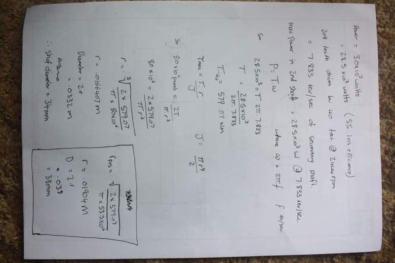

im working on a question that requires me to calculate the minimum shaft diameter for a maximum shear stress. the value is 80mpa. The factor of safety is 1.5, now I am aware that i can't simply increase the shaft diameter by 1.5 to do this correctly. Should I calculate a suitable diameter for 1.5x the 80mpa that is required?
Thanks, I hope its ok to post this here, i don't need guidance on how to work the diameter at all just where to apply the FOS.
Not quite.
The factor of safety is applied to the stress, but we reduce the working or maximum stress by this factor, ie use a stress of 80/1.5 (80 divided by 1.5).
This is important.
We do not design for a higher stress (1.5 x 80) than we know the material will support - we design for a lower stress and the factor of safety is the difference.

"calculate a suitable diameter to the nearest millimetre for the secondary drive shaft for a FOS of 1.5, if the shear stress in the shaft is not to exceed 80MPa when the shaft is under maximum load. (Hint – be careful about the point in your calculations where you apply the FOS. It isn’t just a matter of increasing the final diameter of the shaft by 50%.)"
to be honest i don't actually understand why 1.5x80mpa is incorrect. would that not result in designing a shaft that will withstand 1.5 times the maximum shear stress?
regards.
or am i thinking about this in the wrong way?
Yes you are, so here goes.
You tell me that the maximum shear stress is 80 MPa. That is the shear strength of the material is 80 MPa.
Then you suggest you design for 80 x 1.5 = 120MPa.
How would any shaft of your material support this?
Surely if you actually applied 120 MPa to this material you would break it?
Where is the logic in this approach.
Sorry to be so blunt.
ok i think i now understand. Your bluntness is appreciated haha. I worked the question with both values and now see how designing to 80/1.5 delivers a greater diameter. I've attached the working if you could look over it and see if i have done the correct thing? thanks for your time once again. the actual question is in a link a few posts above.

Yes I will go along with this.
I would recommend explicitly showing the FOS calculation however.
If you do so but cock up the arithmetic you will only loose the arithmetic marks, but if you don't show the step and cock up the arithmetic you will losse the rest of the marks for the question.
For the future:
As soon as gears A and B on the secondary shaft are engaged in transmission they will apply torques to the shaft and the torque will vary along the shaft. So you would have to consider each section individually to find the max.
