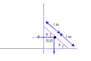

The question is:
A ladder, 2 meters long, is standing flat against a vertical wall. The foot of the ladder is pulled away from the wall. As this happens, the top of the ladder stays in contact with the wall. The process stops when all of the ladder is on the ground. What is the locus of the mid-point of the ladder? (I.e., give a function which describes what happens to the mid-point of the ladder.) I am not sure how to approach this problem so I am posting here, I am going to work on it for a while then go to bed. If someone could help me out that would be great. thanks u

Upper triangle :
[tex]x= cos \theta[/tex]
Lower triangle:
[tex]y = sin \theta[/tex]
Use trigo identity.

[tex]sin^2\theta + cos^2\theta=1[/tex]
This will be the answer actually.

No. the answer is [tex]x^2+y^2 =1[/tex]
yes dats ryt its a cercle (r= 1m)
Set up your coordinate system so that the wall of the house is the positive y-axis and the ground is the positive x axis. The coordinates of the upper end of the ladder are (0, Y) and the coordinates of the lower end are (X,0) where X2+ Y2= 2. The midpoint of the ladder is at (X/2, Y/2). Letting x= X/2, X= 2x so
X2= 4x2 and let y= Y/2 so Y= 2x and Y2= 4y2. Then X2+ Y2= 4x2+ 4y2= 2 so the locus of the midpoint is given by x2+ y2= (1/2) (x and y both non-negative). That is,a the midpoint moves on a circle (actually the portion in the first quadrant) with center (0,0) and radius [itex]\frac{\sqrt{2}}{2}[/itex].
i guess halls of ivy meant X^2 + Y^2 = 4?
