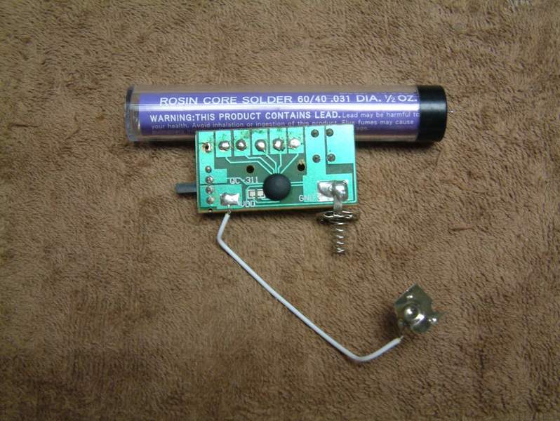

For a Christmas Village display for the houses, I bought a 15 bulb LED light set that is battery powered that I planned to convert to Transformer power so one, it can be controlled by the house voltage timer system I am using for the other lights, and two, so I don't have to keep replacing the batteries.
Actually I bought a 20 light set too and both originally took (3) 1.5V AA batteries.
So with the 20 light set I got a 120 to 4.5V transformer and soldered it to the +/- terminals and all is good.
Unfortunately the 15 set had this 8 function board in it and also unfortunately, none of those functions include just having all the lights stay on.
So about the only way I was able to find to connect the 15 set to be on all the time was to take out the control board and wire them direct.
I have run them this way and for a few minutes and it seems OK but (and also btw my LED knowledge it limited) I think LEDs can't be run this way correct?
Isn't there some type of electronics that needs to be in place to insure there proper operation and continual use?
Basically, if this is the case, as the 15 set is wired directly to the 4.5V trans power, what ever may have been included of this was definitely in the blinker board and is now gone.
So is this OK or should I do something about it?

To your questions, you need to figure out how the LED voltages are being regulated, before you replace too much of any controller boards, etc. They may be regulating using series resistor(s), or with a DC-DC current converter that monitors the LED current(s).
With the parallel LED situation, do you see anything that could be series resistors? Some LEDs have their series current limiting resistor built into them though, so you might not see a separate component. You would need to use a power supply and test resistor to figure out if the LEDs had their current limiting resistors built in.
And on the controller board, are there any switching magnetics components? Either a small transformer or a ferrite slug perhaps?

Hello guys and thanks for the reply's, as there are two, I'll do my best to reply to each one.
First for Berkman, thanks again for the reply and not look a gift horse in the mouth and I know I asked, but to be honest while I understood some of this and do understand all of the terms an parts you speak of, more though, more of it was over my head and as well not something I think I would have the time to work out before the need for this for the holiday.
So as such I thought that while it is not as good as a wiring diagram, that perhaps a few pics of the control board I took out might help, so I have attached them to this reply and they are at the bottom.

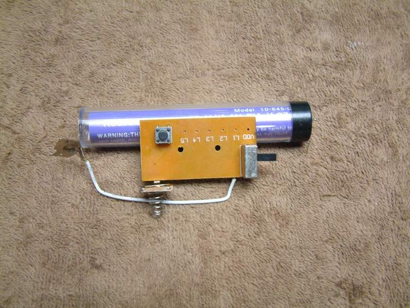

To describe how it was and what I did, this light set which had 15 bulbs was not like most where it had only two or three leads but actually had six. To my best interpretation of it was, one was a positive and then there were five more common negatives, that really to make it known, essentially is one of the ways it was able to performed the various blinking combos. In other words, one of the five commons went to 3 bulbs, then the next to three and so on.
So in looking at the board from its green side, the empty connection to the far upper left was the single positive, and then the next five to its right, were each of these negatives.
So again to describe it, to power the set without this board I just ran the one positive to the positive feed of the transformer, then I soldered all five of the sets negative wires together, and then ran that to the negative side of the trans.
Now for what this board had and again this is just my interpretation, but in looking at this all I see is that one little round chip in the middle, but what this is I don't know. But to me it looks pretty basic and if I had to make a best guess, is just some kind of programmable memory chip used to create the various light combos. But who knows, it could include more.
Btw, to switch between combos, you would push that button you see on the brown side of the board to its upper left and do so consecutively to progress through these combos.
So I don't know if this helps you much Berkman, and I know that was kinda long, but I figured, I'd reply with what I could to best help you with your questions.
