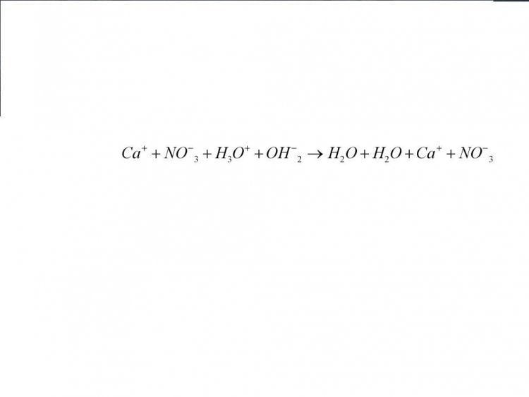

i need to Write the Response Neutralization Equation between Acid solution HNO3 and the solution Ca(OH)2 Calcium hydroxide (base).
in the picture you can see my answer and tell me if i correct.
thanks.

No, not really where did you get OH2- species from?
Only somewhat correct. You are not clear about what your actual reactants and products are. Calcium hydroxide might be treated as a strong base, and nitric acid is a strong acid, so you have an ionic reaction. In your example, simple neutralization. Products are a salt (guess which one) and water.
Omni, please learn how to use forum editor to format correctly your equations. Attaching them as pictures doesn't make sense.

ok i will try to use in what you showed me borek.
and from where i got OH2- i got is from Ca(OH)2. i speak about 100% Response between the acid and the base.
is it Possible that someone can show me the answer?
thanks.

Rethink --- what kind of compound is Ca(OH)2? It is not an acid. How is this compound present dissolved in water? What is the reaction for this?
is a Inorganic compound, i know is not acid is a strong base.
i just mistake in OH2-? in the Equation?
thanks.
Write dissociation reactions for:
KOH
Ca(OH)2
Al(OH)3
(Note: OH2- doesn't mean anything, I told you how to format formulas correctly, please do it).
