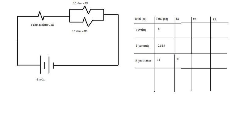

I uploaded a picture of the circuit diagram I'm using. Basically I'm having trouble with filling out the rest of the table.

The attempt of the solution can be found in the picture I uploaded. Any help is much appreciated.
Please I really need help.

You've calculated the current through R1, so what does Ohm's law tell you about the voltage drop across R1?
[Edit: Oh, and by the way, welcome to Physics Forums!]
It may help you to think of the parallel combination of R2 and R3 as a single 6 ohm resistor, R4. Then, you would have an equivalent circuit that is purely series-connected.
What, then, is the current through R1 and R4?
