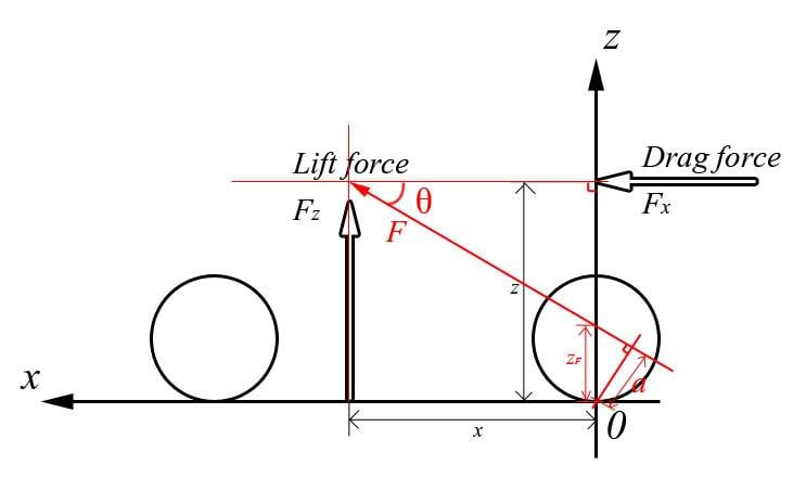

I've performed a CFD analysis on a racecar model which has given my forces and torques (about the origin) in x,y,z. I'm struggling with the interpretation of those results. I'm interested in the point along the x-axis about which the lift force acts.
Both forces are known, Torque about the origin due to these forces is known, the distances at which the forces act are the unknowns
I would state this as Torque(about origin) = (Fxz) - (Fzx)
As far as I can tell there is 2 unknowns, too many to be solved with a single equation? This is a simplified version of my problem, the car is not symmetrical so there is also torque about the other 2 axis and I have tried to solve the three equations this sets up simultaneously but they are unsolvable, but I believe this is because the force in the y direction would not necessarily act at the same point along the x-axis as the force in the z direction. But then putting extra terms in for the different distances means 3 equations and 6 unknowns which leaves the same problem so I'm back to this simplified version.
I've been thinking about it a bit more and come up with this.
The resultant F can be worked out by Pythagoras and angle theta from Theta = arctan (Fz/Fx), and distance 'a' can be had from Torque = Force x distance, I can then use Cos(Theta) = (a/z) to find z and from there I've only one unknown ?

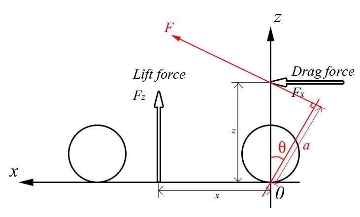

Okay I've drawn that red arrow in the wrong place I'm sure. I think it should be like this
Only problem is I can't see how to get z or x out, there's still two unknowns. I drew the force arrow for lift too long (Fz) it's actually lesser than Fx.

You would normally model the two forces as acting through the center of mass (CM) of the vehicle, so I assume that (x,z) is the CM of the vehicle in your problem. Next you should probably consider if you got the direction of the forces right, especially the drag force which should point in the same direction as the relative wind vector. Once you have your two vectors in order, you can apply them to the CM to get the total force (vector sum of the two).
The torque can now be calculated in a number of ways. If you have the vectors as numbers it is probably easiest to simply apply the vector product between the total force through CM with the displacement vector between CM and the torque axis (see for instance [1] for a diagram and equations).

Hello, thanks for the reply. I don't have the centre of mass of the vehicle, it's just a CAD model at the moment with no material properties applied. x and z are the unknowns, x is the one I particularly want to find as it will allow me to find the reaction forces on the front and rear axle. I have the Torque and force values from my CFD simulation.
Actually that's given me a thought, I think perhaps I should be looking for the point on the car about which there aren't any moments? in which case the red arrow should pass through the origin? I still don't think that allows me to find the size of x and z, just the ratio between them :/

In general in statics, if you have force FA and torque NA about point A, you can change to another reference point B by observing that
FB = FA, and
NB = NA + (A-B) x FA.
In your case, you can for instance use this to find the center of pressure point CP where NCP = 0 or, using A = 0, where CP x F = N with F and N from your CFD tool. The position of CP relative to the geometry of the car should give you an indication if the static aerodynamic forces are "balanced" for a particular car shape. For dynamic stability you want your CP a bit aft and above CM, but since you don't have the CM exactly you may just estimate the area it will be in based on symmetry, engine location and such.
