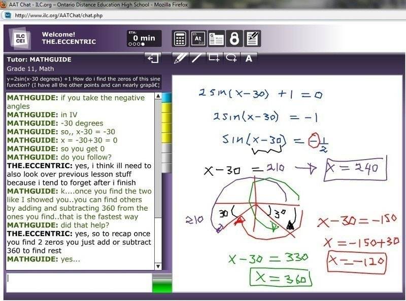

I understand how he got -120 and 360 as zeros, but then there is another zero 240, how did he get that?
Check the diagram i have posted (which was done by the teacher) for simpler version

the teacher somehow finds another zero which is 240...i have no idea how.Ok i see how he did it, but it makes no sense when i try to use the rules

because he is doing it visually, and I am doing it the non visual way

You're mixing up here. θ is not the reference angle. They are angles in the different quadrants. What you wrote shows how to get the reference angle from θ. So, if you want to find an angle in Q III with reference angle 30°, you do this:
θ - 180° = 30°
or θ = 210°.
But θ is the angle whose sine is -1/2, or θ = x - 30°. So x = 240°.
In Q IV, you set up like this:
360° - θ = 30°
or θ = 330°.
Again, since θ = x - 30°, x = 360°.
Those are the only two angles you need. You also had x = -120°, but because θ = x - 30°, θ = -150°. -150° is coterminal with 210°, so there really is no need to list the answer x = -120°, unless x is restricted in some way.
For instance, in many problems like this, the directions would include 0° ≤ x < 360° as the restriction for x. If that is the case for your problem, then you would have to say that the answers are x = 0° and x = 240°. You would have to change the answer x = 360° to x = 0°, because x has to be less than 360°, so you have to get the coterminal angle for 360° within the range of x.
