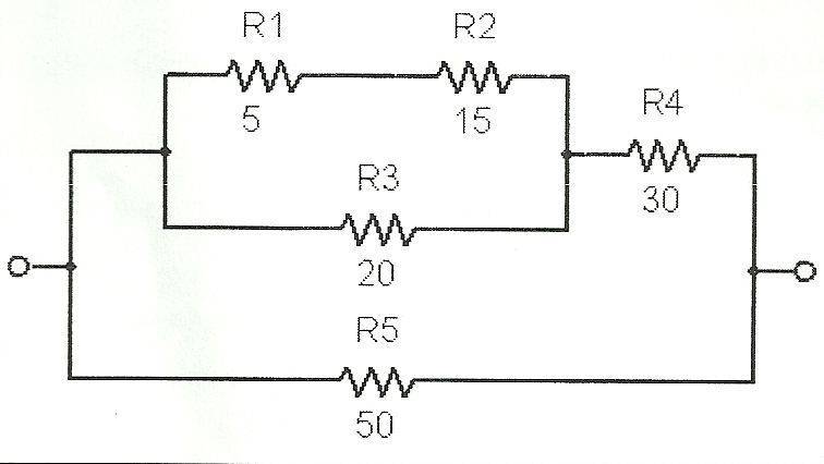

Well, this is the circuit (attached). There are 5 resistors. So if say each resistor has a 1W power, a total power of more than 5 will definitely cause damage?
Not necessarily.
Start by labelling the outer two terminals A and B.
Then ask yourself, "How could the power be applied?"

Now let's say we put a voltage V on the left side (call it A), and set the right side (call it B) to Earth (that is a voltage of 0 V).
A current will start flowing that we will call Ia.
Let's take a look at resistor R5 which is 50 ohm.
Since there is a voltage V, there will be a current I5 = V / R5 = V / 50.
The dissipated power in R5 will be P5 = V2 / R5 = V2 / 50.
So we can say that if V is such that P5 = 1 W, then R5 will blow.
This would happen if V2 / 50 = 1 W, which means V = √50 = 7.07 V
Now if we would calculate the Req of the circuit, we know that the total power dissipated in the circuit would be Pmax = V2 / Req which you could already calculate.
Note that you would have to check the dissipated power in the other resistors as well, to see if they would already blow with a lower V.

V is applied between A and B
So the current in R5 is V/50
Now R1+R2 is 20,
put this in parallel with R3 the effective resistance is 10
add this to R4 to get 40
So the current in R3 is V/40
I will leave you to split this to calculate the currents in R1 and R2.

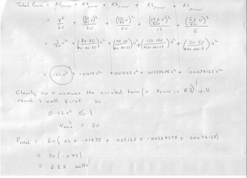

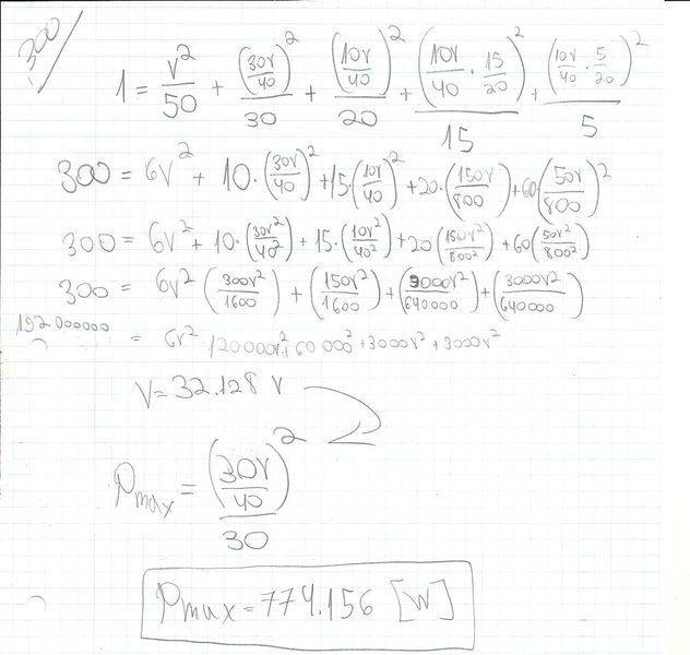

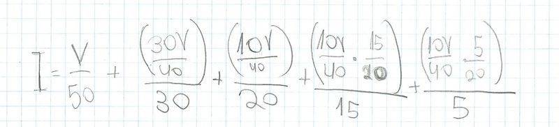

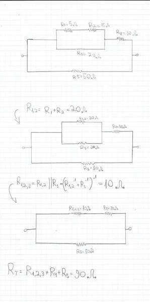

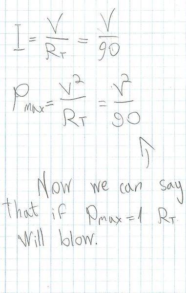

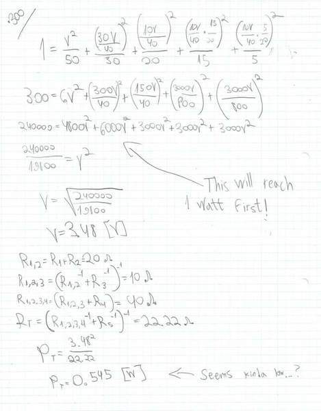

I like Serena, I followed your lead verbatim. Attached. Do I get your seal? (btw come to think about it, this should've been posted in the HW section. I just didn't expect you all to be so nice and lead up to my question)
But I can just do Rtotal without having to calculate each separately, right?

The voltage across R5 is V
The voltage across R4 is V times 30/40
The voltage across R3 is V times 10/40
The voltage across R2 is V times 10/40 times 15/20
The voltage across R1 is V times 10/40 times 5/20
Edit
I think it more important that you can follow the above, rather than that you can find a short cut, because this is really a test of your understanding of combined series and parallel circuits.

Fair enough, but if they're asking me for Pmax why do I need to provide them results in terms of voltage across each R? :confused:

Sorry, no seal yet ;)
In your total resistance you were right in your calculation of R1,2,3. But then you added the other resistors. This would only be correct if they were all in series, which they are not.
And in your second sheet you write that if Pmax=1, that RT will blow.
But that's not correct either.
What you would have, is that with Pmax=V2/RT=(√50)2/22.22=2.25 W, that R5 will blow.
The resistor RT as such does not exist - it is only an "equivalent" resistance.
If anything blows, it will be an individual resistor.
I have (randomly) picked the resistor R5 to see when it would blow.
But any of the others may blow as well.
That's where Studiot's list might come in handy, because he's given you the voltages across each resistor. With each voltage and the corresponding resistance, you can calculate the power dissipated in each resistor with the formula P=V2/R
I added them in parallel where they're in parallel , then they became in series. That's how I've been doing it in class to get the right figures. Now I'm wrong with that, too? Great, I'm back to just knowing ohm's law, and even there my confidence is shaken :P
You can firm up your own beliefs again, because between your 2nd and 3rd drawing you did apply the law correct for parallel resistors! :smile:
In your third drawing you have R1,2,3 in series with R4, so those add up.
Then I guess you should have made a 4th drawing with R1,2,3,4 which is in parallel with R5...

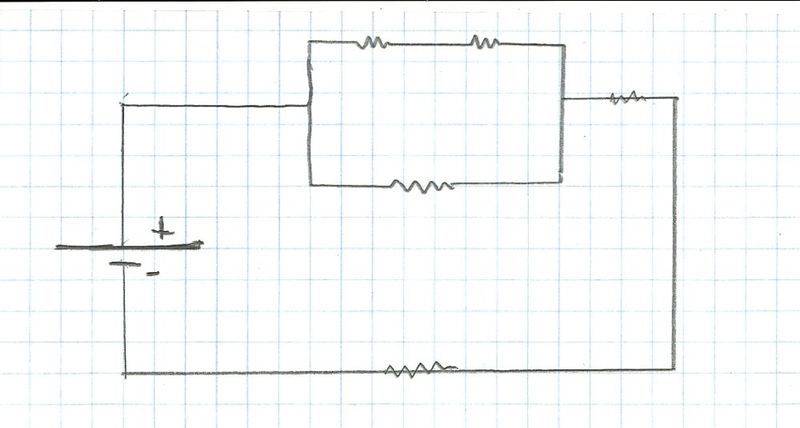

I went with the conclusion that the power source is wherever I want it to be. If the power sources are between the two points then yes, I'm aware that my drawings would be wrong. Shouldn't the power source be defined a location?
Confused :confused:
The power source would be for instance a battery with the positive pole on the left side of the circuit and the negative pole on the right side of the circuit. It is not part of the circuit.
This would cause a "voltage difference" across the entire circuit. And because it is a battery, this voltage would be constant, regardless of the current flowing.
Typically we would assign the left side of the circuit a "voltage amount" V, and the right side of the circuit a "voltage amount" 0.
Yes, I know, this was the circuit in my mind (attached). But I guess I'm not allowed to define the source wherever I want. It's just that it wasn't defined on the question or in the drawing, so I've taken the liberty, heh.
Thank you so much for the detailed reply and the encouragement Serena, and everyone. I'll try reading on some guides and going over my notes again to see how to solve this question. If I ever do solve it I'll post back here. Will definitely use all the replies here as referrence when I try. It might take time. But, anyway, even while having failures after failures, it's always good to try :) What doesn't kill you makes you stronger...even though in electricity it often just kills you. heh.
I'm glad you know Kirchoff's laws.
However what I did is much more fundamental and can be done by inspection.
Since it seems like magic I will walk you through it (It is actually called a walking through analysis in electronics)
Firstly label the terminals A & B as I said. These are the small circles to the left and right of your diagram.
Apply any voltage V across these terminals. So V volts appears across AB.
Now R5 is connected directly across AB so the voltage across R5 is V.
In the other leg of the circuit you have a complicated arrangement containing R1 through R4.
However can you see that this leg is also connected directly across AB?
So the voltage across the whole leg is V.
R1 & R2 are in series and add up to 5+15 = 20
This series pair in in parallel with R3 and so is 20 in parallel with 20 = 10
So the second leg has 10 in series with R4 ie 10 in series with 30 a total of 10 + 30 = 40
As already noted the voltage across this is V
In a series circuit the total voltage (V in this case) is distributed in proportion to the resistances in series to the total.
So the voltage across R4 is 30/40 times V
And the voltage across the combination of R1, R2 & R3 is 10/40 times V.
This voltage (10V/40) is directly across R3 so is the voltage across R3.
It is also the voltage across the series combination of R1 and R2, again distributed in proportion
So voltage across R2 is 10V/40 times 15/20
and voltage across R1 is 10V/40 times 5/20
Now that we have all the voltages and resistances we can assemble an equation for the total power
[tex]Powe{r_{total}} = \frac{{V_{R1}^2}}{{R1}} + \frac{{V_{R2}^2}}{{R2}} + \frac{{V_{R3}^2}}{{R3}} + \frac{{V_{R4}^2}}{{R4}} + \frac{{V_{R5}^2}}{{R5}}[/tex]
Substituting
[tex]= \frac{{{V^2}}}{{50}} + \frac{{{{\left( {\frac{{30V}}{{40}}} \right)}^2}}}{{30}} + \frac{{{{\left( {\frac{{10V}}{{40}}} \right)}^2}}}{{20}} + \frac{{{{\left( {\frac{{10V}}{{40}}*\frac{{15}}{{20}}} \right)}^2}}}{{15}} + \frac{{{{\left( {\frac{{10V}}{{40}}*\frac{5}{{20}}} \right)}^2}}}{5}[/tex]
Now if we examine each of the 5 terms in this expression the one with the largest numerical coefficient of V2 will be the one to reach the 1 watt limit first.
Do you follow this reasoning here?
If we set this equal to 1 watt we can solve for V
Then we can back substitute and determine the total power.
The arithmetic is not really so fearsome as it looks - really.
Since I have done all the work for you in the votlage analysis, you could also perform a similar analysis with current instead of voltage.
Allow a current I to flow from A to B through your network and calculate the currents in each resistor in terms of I. (no voltage assumptions are required in this case)
Assemble a total power equation as before using power = (curent in each resistor)2 time the resistance.
Solve for I using the term with the largest coefficient.
Back substitute I to get the total power.
go well
You're incredible, Studiot. Absolutely incredible. I will definitely print this post and add to my notebook. I WAS able to follow you, actually, and fathom the concept thoroughly with this analysis and see exactly what you did. This is perfect. Exactly what I needed.
I'm not sure if I got my arithmatic right in the calculation I attached now but I understand how you got there. I'm not actually used to seeing a voltage source where the + is on one end and the - at the other-- it threw me off. Thank you for caring enough to post it, Studiot.

Whilst I agree with multiplying the equation through by 300, I don't make the second and later terms the same.
your 10 etc should appear ouside the brackets, not inside where you have them.
that is
[tex]\frac{{{{\left( {\frac{{30V}}{{40}}} \right)}^2}}}{{30}}*300 = 10*{\left( {\frac{{30V}}{{40}}} \right)^2}not{\left( {\frac{{300V}}{{40}}} \right)^2}[/tex]
etc
Looking again at my 2 equations I see I have reversed the order of terms between the first and second, although both are correct. Sorry if that caused confusion.
Right, algebra kinks. I will work it out better, thanks.
Shouldn't the first term -> V^2/50 have brackets separating the ^2 from the V/50?
