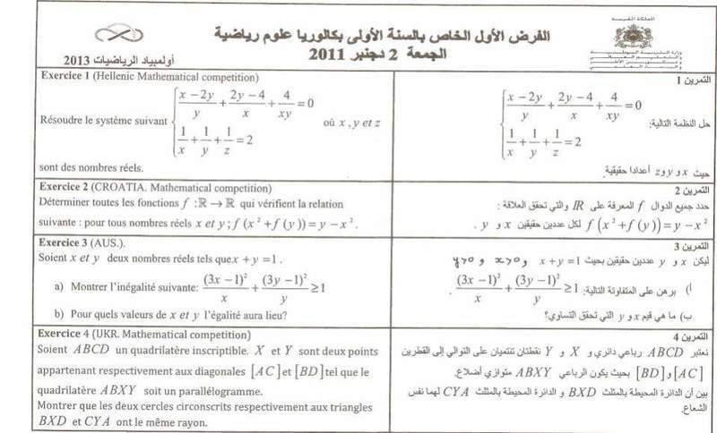

That's the question, its the second one if you understand some french micromass.

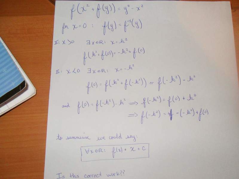

Case: y=0:
f(x^2+f(y))=y-x^2 <=> f(x^2)+f(f(0))=-x^2 <=> x^2+fof(0) = f^-1(-x^2)
<=> x^2=f^-1(-x^2). :redface:
In your first line you use f(a+b)=f(a)+f(b). But you don't know whether that property holds! So you can't do that!
What solution did u get for Y=0 just curious to know.
