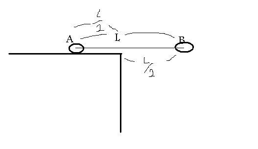

Two small balls of the same mass and shape are attached by a massless string of length L. Ball A is placed on a frictionless table and ball B is held a distance L/2 over the edge with the string taut.
When ball B is dropped, will it hit the side of the table before A reaches the edge or will A reach the edge first?
You do not need to write any equations for this question, just explaining your reasoning will suffice.
None given.
I was thinking that this problem had something to do with a pendulum, as when B is swinging down about the point where the string leaves the table, it moves so in a "pendulum-like" fashion. Maybe it has something to do with angular momentum.
Honestly, the problem could also probably be solved with just a simply free-body diagram utilizing Newton's Second and Third Laws, but I just don't know how to approach this.

The amount of string over the edge of the table is r(t): r(0)=L/2.
At t=0, B starts accelerating downwards, pulling A and making r longer. The tension on the string changes the motion of B into an arc.
This is the sort of thing that is done rigorously with hamiltonian mechanics, but you should be able to reason it out from first principles.
note: if r(0)~0, the B hits the wall first, if r(0)~L then A falls off the edge first.
Is r(0)=L/2 the sweet-spot where they hit at the same time?

Well sure, you said so yourself - draw a free-body diagram for each mass, write the relations for the forces. For B, the angle of the tension force will change during the motion. You want to relate this to how far away the side of the table is - because B's motion in that direction is what you care about.
If B has fallen distance y, then it is x away from the table and the length of the string from B to the table is r. If the angle the string makes to the horizontal is Q, then sinQ=y/r and cosQ=x/r
The acceleration of A is given by a=T/m, which is also tells you how r increases with time... is there constant acceleration though? What determines the acceleration of B in the x and y directions? How are these related to the acceleration of A?

Will A fall off first because it accelerates at some a, while B accelerates in the x-direction at some value a_b < a, because gravity is split up into lesser components??
That's the kind of thinking that the problem is looking for.
The total acceleration of A and of B must be the same (a) at all times - because the string attaches them. Thus the x component of the acceleration of B will always be less than a (re. Pythagoras). They each have the same distance to cover. I'd go with that if I were you. Mind you, I cannot guarantee that's the right answer - with these types of questions it's seldom about getting it right and more about making your case anyway ... and I'm not the one marking it.
