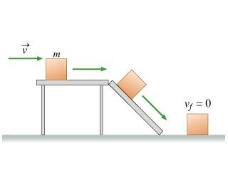

The problem is:
A block of mass m slides at a speed v along a horizontal, smooth table. It next slides down a smooth ramp, descending a height h , and then slides along a horizontal rough floor, stopping eventually.
If the zero level is a distance (2h/3) above the floor, what is the potential energy U of the block on the floor?
I'm confused about the zero level.
To specify the potential energy, you need a reference point--a place where U = zero. For example, if the ground were the zero point, then the gravitational PE of an object at a height h would be U = mgh; but if 2h/3 were the reference point, U = mgh/3.

With U = mgh, where do you measure h from?
You measure it from the zero level, which is completely arbitrary. For example, if a mass is on the floor, and I choose the floor as the zero level, then h = 0 and U = 0. But what if the zero level were chosen to be 10 meters below the floor (in the basement, perhaps)? Then h = 10m.
Another way to write the potential energy formula is: U = mgy, where y is the vertical position measured from the zero level, which is where y = 0.
The point is: You can put the zero level anywhere.

jcarreon0807 said:
Anyway, if the U=mgh/3 on the table and zero point is 2h/3 then wouldn't that mean that the zero point is above the table since 2/3 is bigger than 1/3.
No. That would be a contradiction, since you just said that the zero point is at 2h/3.
The point is to choose the zero point (in this case it's given to you), and measure the displacement from that point. If the table top is h/3 above the zero point, where is the floor measured from that same zero point?
Ok now I get what it is saying. Thank you for clearing it up!
