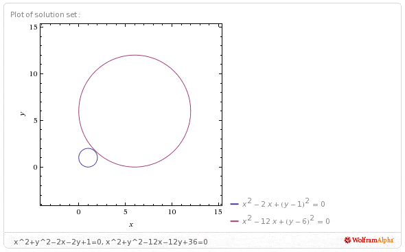

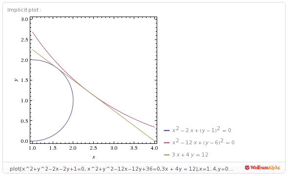

Graphing the two circles may lead one to think that the circles share a point of tangency. I did just that using Wolfram Alpha. I then included the given line, 3x + 4y = 12, and zoomed-in.

Nice pictures SammyS!
A pair of tangent lines to two circles are mirror images of each other to the line that connects the centre of the circles.
The centres of the circles (x-1)2+(y-1)2=1 and (x-6)2+(y-6)2=36 are (1,1) and (6,6); both lie on the y=x line. So a graph of the circles and the tangent lines is invariant when x and y are exchanged. With the change x<=>y in the equation of a tangent line, you get the other one.
