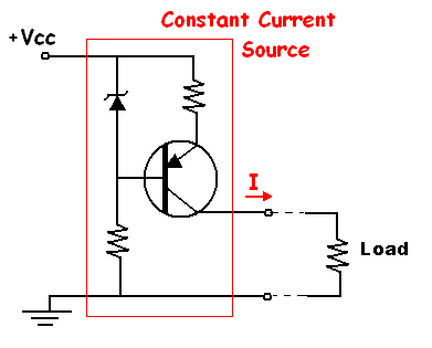

Thanx for giving me good response. I am new to this forum. I never joined any forum before. I ll be a regular user of this forum now onwards.
i have seen on net written van de graaff generator is a current source.
the bottom end of a lightning bolt would be a good example of a current source.
It's going to develop whatever voltage is necessary to dump its charge into earth.

sirsajid said:
...what is the practical example of current source
This is commonly used as a (constant) current source:

As Rogerio showed, a current source is generally the output of a transistor or tube or other nonlinear active circuit element. Batteries and generators are considered voltage sources. It is generally a secondary, dependent source.
