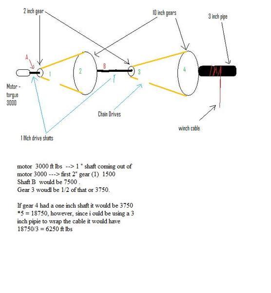

Hi Guys :
I have been reading about torque and gears and not being an engineer or physicist would like to know if my thinking is correct in the following example
Ok so Say I have a hydraulic motor and it generates 3000 ft lbs of torque and it is going to be turned at 650 RPM (tractor PTO) please see pic to explain this
Coming out of that motor is a 1 " shaft. Therefore the torque at the 1" shaft is 3000. Ok if I put a 2 " pulley on that shaft its torque would be 1/2 of that or 1500.
NOw I will connect the 2" pulley to a ten inch one by chain. THat 10 inch pulley also has a one inch shaft So now the torque of the the one inch shaft on that the 10" pulley would be 5 x as much or 7500 . If I put a 2" gear on the end of that one inch shaft I again lose half my torque and am down to 3750.
ONce again I connect that 2" gear to a 10 inch one and that would give me 5 x as much torque - if I had a one inch shaft coming out of it 0r 3750 *5 = 18750.
However instead of a one inch shaft I will have a 3 inch pipe to wrap the cable on so that will have 1/3 as much or 6250 lbs.
Are these assumptions correct? Really appreciate any help

Your assumption that changing shaft diameter affects torque is incorrect.
Keep showing units with answers to all calculations.
In the chain drive, calculate chain tension (force) using the equation:
force = torque / distance
In this case, the distance will be the radius of the sprocket or:
F = T / r
After calculating chain tension, convert back to torque in the axis of the 10" sprocket.
T = r X F
You will need to convert from torque to tension and back twice (once for each speed reduction stage).
In the end, the torque at the axis of the 2nd 10" sprocket will be equal to that in the 3" pipe. I would convert the torque in the pipe to force in the cable attached to the pipe (use the equations above).
I hope that helps with your initial torque calculations.

HI:
Thanks for your answer. I guess this is where I am getting confused - you say that changing shaft diameter will not affect torque -
This is what I don't understand - on the last pulley if I had a 1" shaft sticking out you are saying that this 1" shaft will pull with the same force as a 10" shaft -??
sO SAY THE 1" SHAFT CAN PULL 7500# ARE YOU SAYING A 10" SHAFT COULD PULL 7500#?
SAY THE RPM OF THE SHAFT IS 1OO
THE 1" SHAFT WOULD THEN PULL IN A 7500 # LOG 314" IN ONE MINUTE
WHILE A TEN INCH SHAFT PULLING 7500# WOULD PULL THE LOG IN 3140 INCHES IN ONE MINUTE
IT SEEM TO ME THAT THE FORCE WOULD BE MUCH LESS WITH THE TEN INCH SHAFT THEN THE ONE INCH SHAFT ?? aM i USING THE TERM TORQUE WRONG ??

No, that is not true. If you need to pull with a force of 7500 lb by applying torque through a 1" shaft, you must apply 3750 in*lb of torque to the shaft. The same 3750 in*lb of torque will only result in 750 lb of force to the cable. The torque in the shaft is the same, the force available changes as the distance from the axis changes.

It looks like you already have lots of good answers, but let me see if I can simplify it for you.
You have two 5:1 gear reductions for a total of 25:1.
So you will have 25 times as much torque coming out as you put in, ignoring frictional losses.
Your first small sprocket sees the same torque as the motor.
Your first large sprocket sees five times the torque.
The second small sprocket sees the same five times.
The second large sprocket sees 25 times the torque, as does your winch drum. That would be 75,000 ft-lbf.
You have a 1.5 inch radius on your drum. Let’s assume that you have half inch wire rope on the drum, so the effective radius is 1.75 inches. So your maximum expected line pull is:
75,000 / (1.75/12) = 514,000 lbf.
Just broke your half inch rope. It was rather large for a three inch drum anyway.

Hi MSN56 -
This isn't correct:
OK so if you look at my orginal drawing if i have the motor that has a 1 inch shaft and has 1000 ft lbs of torque that means it can pull at 1000 # at the shaft.
If a motor is rated at 1000 ft-lbs of torque, and has a 1" shaft, it means that *if* you put a pulley with a 1ft radius (2ft diameter), it would pull 1000 lbs on a rope wrapped around that pulley.
But your later comments give me the impression that you do understand, and that earlier comment was just a typo. (Then again, I may not be getting it quite correctly either!)
So back to your original problem: when using pulleys and gears, the ratio changes the torque, but not the power. Neglecting efficiency losses, the power in remains the same no matter how much you change the gear ratios. Thus to maintain the same power, as you change the ratio, if the torque goes up, the speed goes down, and visa-versa.
In your original post, look at the overall ratio change. In the first stage, you go from a 2" pulley to a 10" pulley. That's 1:5. The torque goes from 3000 ft-lbs to 15000 ft-lbs. Note the RPM's drop by a factor of five to 130 rpm
Then you do it again, 2" to 10" which is 1:5. Torque now goes up 5x more, to 75000 ft-lbs, while rpm is down to 26. (Total power still hasn't changed, except for friction losses).
At this point the torque is unchanged whether you end with a 1" shaft or a 3" pipe. It's still 75000 ft-lbs, meaning if you attach a 1ft lever arm on that shaft or pipe it would pull 75000 lbs. (see why the shaft diameter doesn't matter for *torque*?). What the shaft/pipe diameter *does* affect is the force - not torque - you can pull at the circumference of the shaft, such as using a cable wrapped around it.
So, 3" is 1/4th of a foot, thus the pulling force is 4x the 75000 = 300,000 lbs force. By the way, that's a helluva lotta force -- I think you'll see practical limits come into play here, like crushing your bearings or snapping the cable.
Hope this helps, (and hope I got it right)!
