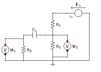

I have the following circuit...
I have managed to derive an equation for U2:
Now I want to substitute U2 into U1, in order to derive equation for U1
I have defined U1 as:
Now I substitute U2 into the above equation. This is how far I get...I am stuck...

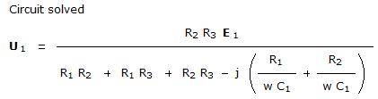

My circuit simulator is saying that U1 is equal to:
However I cannot simplify to get this equation. Can someone please help I have spent hours trying to get U1 to look like the U1 that the simulator produces.
I thank you in advance.
Have you try to replace R1, R2 and E2 with his Thevenine equivalent circuit ?
Eth = R2/ ( R1 + R2 ) * E1 and Rth = R1||R2

No I haven't tried this before, but I did just try it and I still can't derive U1. Perhaps I am being stupid...
A made a small error instead of V3 I should write U1

IMy circuit simulator is saying that U1 is equal to:
What is the name of your simulation program?

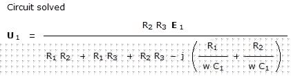

Thanks for your help Jony, the simulator is giving me this equation:
I haven't derived that myself^. When I expand out the equation you derived:
[tex]V3 = \frac{E1*R2*R3}{(R1+R2)\sqrt{(R1||R2 + R3)^2 + Xc^2)}}[/tex]
I still not can get a the equation looking like the simulator one.
BTW the simulator is called Solve Elec, you can download it for free.
[URL="http://www.physicsbox.com/indexsolveelec2en.html[/URL]
Ah done it! you are right I was being stupid. I am upset with myself that I never thought to do a thevin equivalent :( thanks a lot for your help. I can sleep peacefully tonight.
