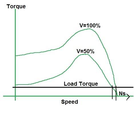

If we have started talking Induction motor, then, as is popularly believed, the motor can get damaged by applying reduced voltage.
See the Torque Curve of Induction motor for 2 different applied Voltage
The diagram isn't quite to scale, but please bear with it.
Now, as can be seen, reducing the voltage has only slight effect on the speed. (How much the effect will be is dependent on the design parameter of the motor). Since the Load Torque is assumed constant, it follows that the output power remains more-or-less constant.
Now, since the input voltage has been greatly reduce, the only way the output power is maintained is by consuming more currents.
Of course, this can be explained in terms of the motors equivalent circuit diagrams, and explaining how the effective resistance of the motor decreases with reduced voltage due to magnetic phenomenons etc etc but Energy Conservation Principle Gives a straight answer.
