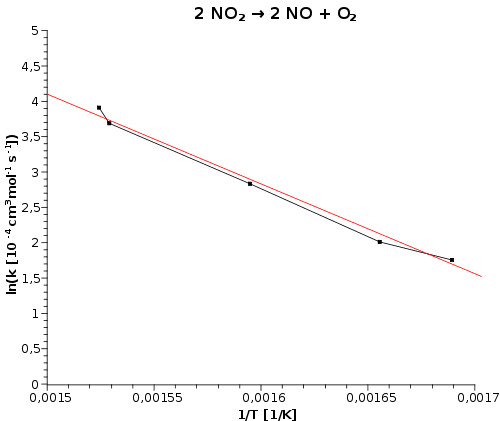

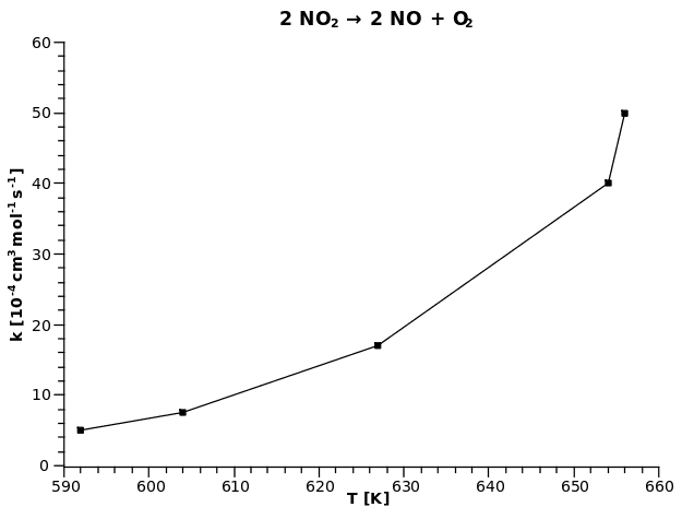

I am talking about this graph from the wiki page:-
No, i don't think this one is log based.
okay so the bottom chart is an arrhenius plot plotting 1/T vs ln(k) as defined in the wiki page and the upper chart is the same data but plotting T vs k.

Oh yeah, that's look like something which i am looking for. You made the graph for very small values of x but i don't think that this is correct because in the wiki graph, temperature is increasing to high numbers but it isn't turning like to be that of y=e^(-1/x).

Well, the formula is undoubtedly based on the shape of the graph when plotting ln k versus 1/T.
Then you apparently get the graph:
This is approximated by a straight line.
With the relationship ##\ln k = c_1 - c_2 \cdot \frac 1 T##, you can deduce that ##k=A e^{-\frac B T}##.
When I make an approximation of this, I get the following graph:
http://www3.wolframalpha.com/Calculate/MSP/MSP65161a10geiaaagg40a900000h0fa40fba06a13c?MSPStoreType=image/gif&s=30&w=300&h=191&cdf=RangeControl
plot[ k=18e9 * e^(-13000/t), {t,590,660} ]Doesn't this kind of fit the expected graph?

A straight line is defined by the equation:
$$y = a x + b \qquad\qquad (1)$$
where ##a## is the slope of the line, and ##b## is the y-coordinate where the line intersects the y-axis (the y-intercept).When we fit a straight line to a set of points, we try to find out what ##a## and ##b## have to be.In this case we have ##\ln k## on the y-axis, and ##\frac 1 T## on the x-axis.
So we replace ##y## in equation (1) by ##\ln k##, and we replace ##x## by ##\frac 1 T##.
The result is:
$$\ln k = a \cdot \frac 1 T + b$$
Since we already know that the line slopes down, I have taken the liberty of putting in a minus sign, and rewriting the equation with different constants ##c_1## and ##c_2## as:
$$\ln k = c_1 - c_2 \cdot \frac 1 T$$
