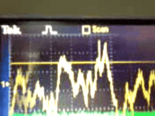

At output of LM324, 50 mV low frequency (Around 5 to 10 Hz) oscillations were observed when it was used as attenuator for pure DC application...what could be the reason?

Capacitor is Not connected(NC)...is that noise?
what it should be called? I have attached o/p waveform ...Each division is 50 mV...is that noise? what it should be called?
Waveform is captured in CRO AC coupling mode...Even in multimeter oscillation was clearly visible as digits kept on changing...
Have you tried swapping the op-amp? Occasionally you get a defective one that "works" but has a high noise level.
I need a picture of your physical circuit. I want to see your layout. The waveform don't look oscillation, it is some noise you pickup.
I also need a scope picture with longer time scale to see the repetition. Tell me the time scale as I can't see it. It looks like some periodic signal from the picture, but need wider time scale to tell.
Picture first, talk is cheap at this point, if you did it right, the circuit should work, no if and buts about it.
