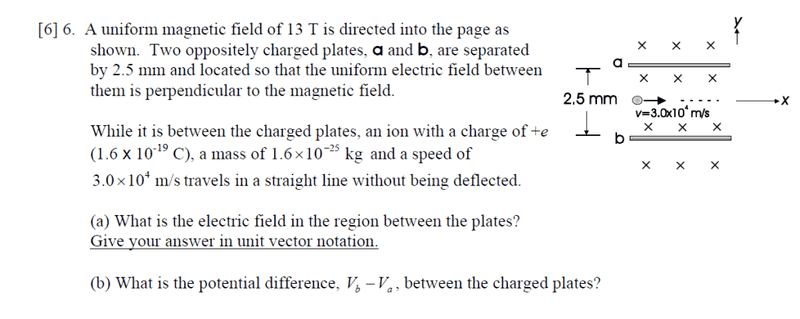

Charged particle within an electric field
The discussion centers on the behavior of a charged particle within an electric field, specifically addressing the confusion surrounding the application of the equation a=qE/m when the particle's velocity is constant. Participants highlight the relationship between electric fields and electric potentials, noting that the magnetic field's inclusion suggests a balance of forces acting on the particle. The magnetic force's role is emphasized, indicating that it cancels out the electric and gravitational forces, leading to inquiries about its calculation.

I can honestly say I've never been this confused by a question. At first my mind automatically went to a=qE/m since I have both charge and mass, but it became apparent that the equation was irrelevant because the velocity is constant. I thought it might be possible that I'm supposed to obtain the electric field by taking the integral of the electric potential, but I don't understand how I can get that using the information I have, and I have no sweet clue why the magnitude of the magnetic field is included.
It means the magnetic force exactly cancels the electric force (plus the gravitational force). What's the magnetic force on the ion? :wink:
