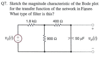

I'm trying to find the Transfer function of the circuit below so that I can draw the Bode plot for it. I chose to use Laplace because I think it made it a little simpler.
My equations so far:
KVL of Left Loop: EQUATION1
Vs=I1(900+1800)-900I2
KVL of Right Loop: EQUATION2
0=((2E6)/s+400+900)I2-900I1
EQUATION3
Vo=I2*(2E6)/s
Rearranging EQUATION2 gives:
I1=(1/900)((2E6)/s +1300)I2
Substitute this back into EQUATION1 to get Vs in terms of I2 and s.
When I do:
H(s)= Vo/Vs
I get:
H(s)= 5000/(3(s+5000))
Which I'm pretty sure is wrong.
I think you'll want to check the math for your capacitor impedance; 1/(50E-6) is not 2E6.
